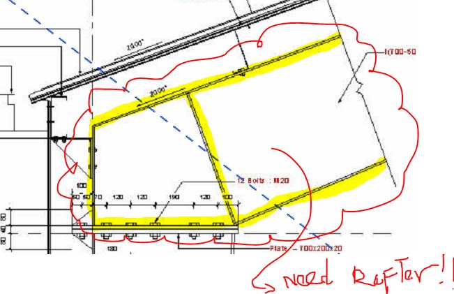

I need a Families only for Rafter of Pre Engineered Frame (see attached pictrure). I used to search Pre Engineered Buildings Families but did not see.
I'd like someone send this family to help me or show a away how to make it. Thanks in advance

That is not a rafter - It is a pre-engineered rigid frame and they are in the downloads.
http://www.revitcity.com/downloads.php?action=search&keywords=pre-engineered&user_name=&sort=score

Thanks. It's tapered beam and link
http://www.revitcity.com/downloads.php?action=search&keywords=tapered+beam&user_name=&sort=score

I think you need to talk to some Pre Engineered folks because what you posted is a rigid frame.  That is why you have the moment joint at the column that shows in the image you posted.  The rigid frame families are better suited for PE buildings rather than individual components like tapered beams.
