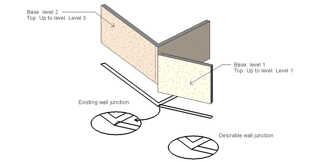

Wander how to clean the junction in the attach drawing, been trying everything that I know of and still can not solve it?
( I am using Revit 2008 )

Hi, try to join the geometry and let me know.
-paolo

Thanks, it seems to do the trick.
