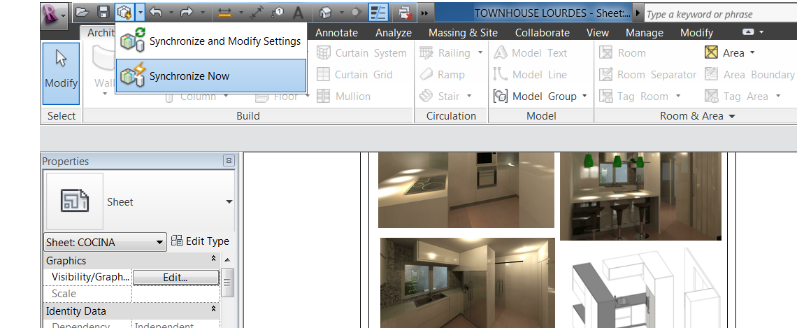

Mon, Jun 15, 2015 at 12:22:46 AM | element was deleted in central file
anavel2008
anavel2008 Avatar
Joined: Thu, Feb 11, 2010
0 Posts
4 Stars: 3 Votes
click on:           Sinchronize now               in in the ribbon near of Save
Bring back deleted element.
