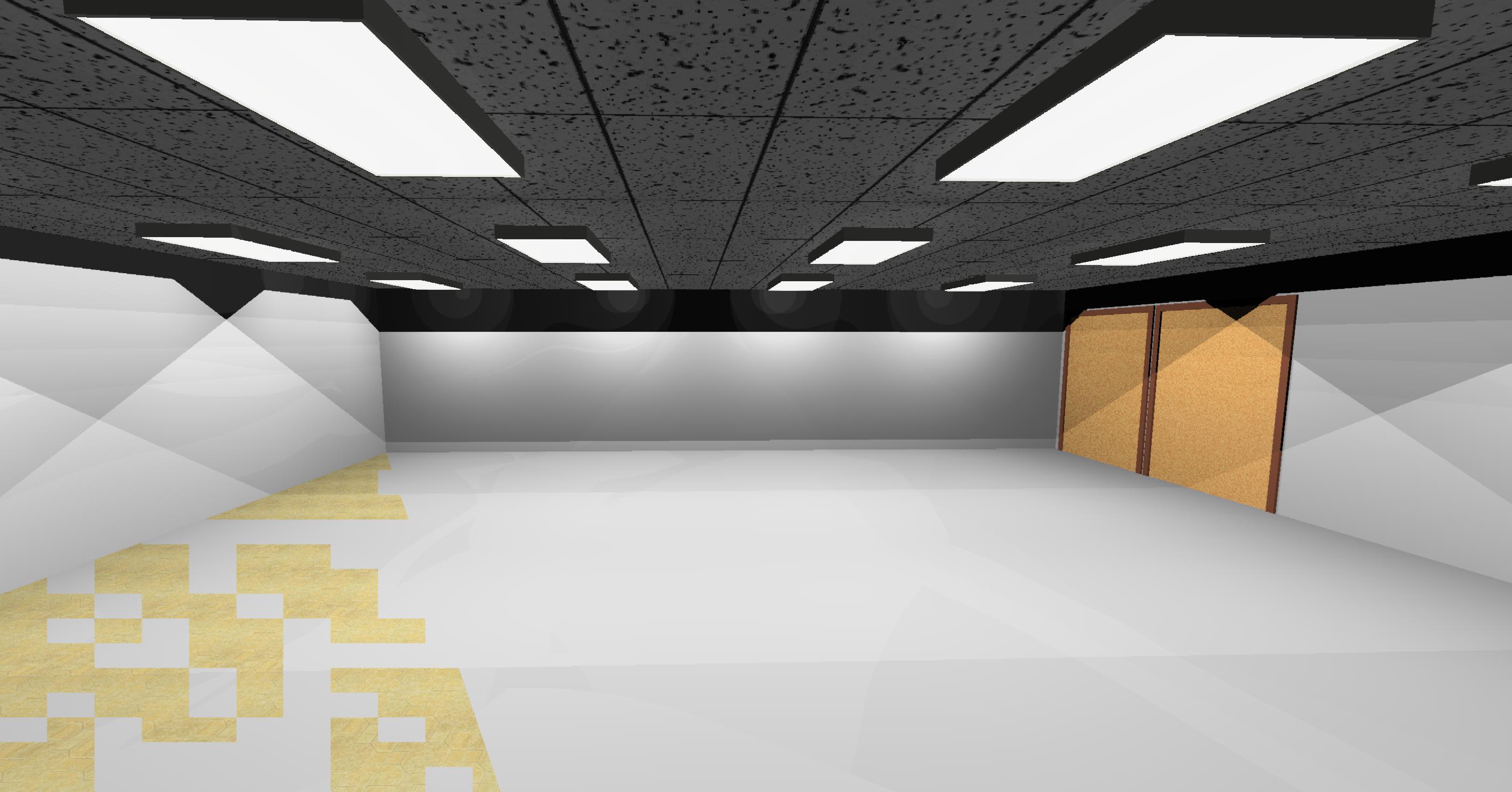

I am new to Revit first off.  Whenever I go to render a room through a walk-through view the floor shows up splotchy almost.  I am just using a generic flooring and using paint for the seperate sections.  Parts of the flooring will show up fine and then parts will just show through to the generic flooring.  What and how much shows through depends on the angle.
 Is there any easy fix for this?

It's more so the floor is pixelated
 hopefully this image works on this forum format
[IMG]http://i13.photobucket.com/albums/a278/datsunissan28/Walkthrough5.jpg[/IMG]

The floor types are merging. try raising the floor .25" this usually helps.

I think AR1237 is right.
on another point, why do you render your walkthrough? obviously your render output is not for presentation, try shaded view with edges, much quicker and will look ok too Smile
