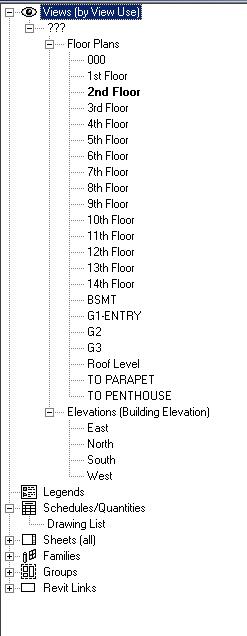

Mon, Jun 30, 2008 at 3:51:24 PM | project browser sub-folders
#11
dprado
Joined: Mon, Jun 30, 2008
20 Posts
 i used the previous link and tnx WWHub you were a lot of help, I hope you can help me with one more thing.  As of right now i have one folder called ??? and within that i have 2 sub-folders (Floor Plans, Elevations) How can i create more folders under the Views(byView Use).  In other words i'm trying to create a folder and and later add other sub-folder views.
