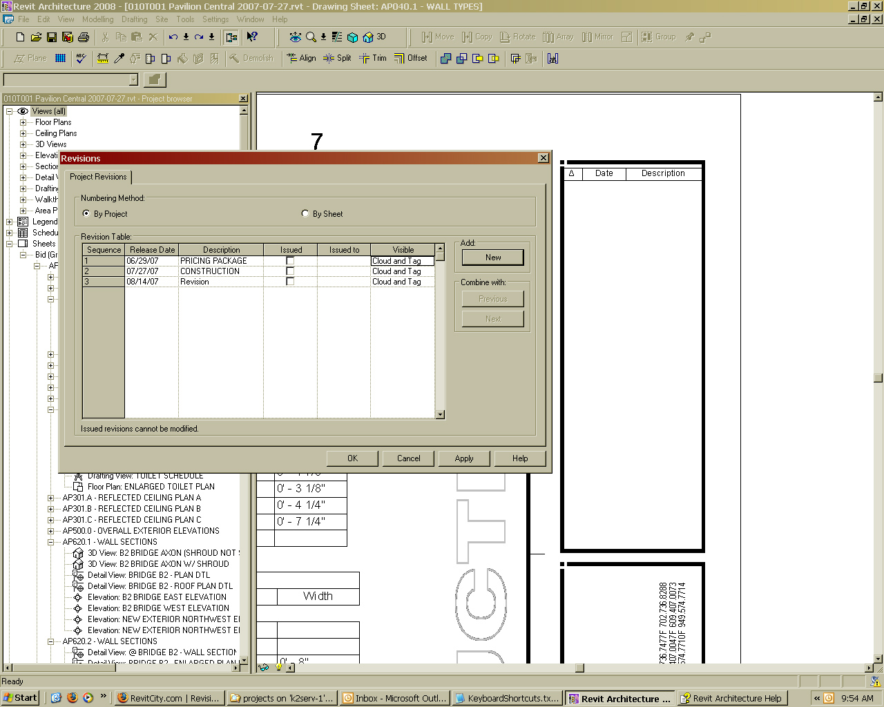

I've followed the help menu on adding a revision schedule to the titleblock family, loaded it to the project, then I set my revision settings in the project, I've drawn revision clouds within the project associated to the revision sequence numbers, and yet nothing shows in the revision schedule. what am i missing?? Revit 2008

Ok, I figured out 2 things:
Rev clouds in legend views doesn't seem to update the schedule but all other views do.
Rev schedule for a given sheet doesn't show any revision line unless a rev-cloud is on that sheet or within a view on that sheet. I noticed another person's work-around for this is to make small negligible rev-clouds in the corner of every sheet. I think that revision scheduling might be one more thing that is better to do the old fashioned way.
Am I wrong?
