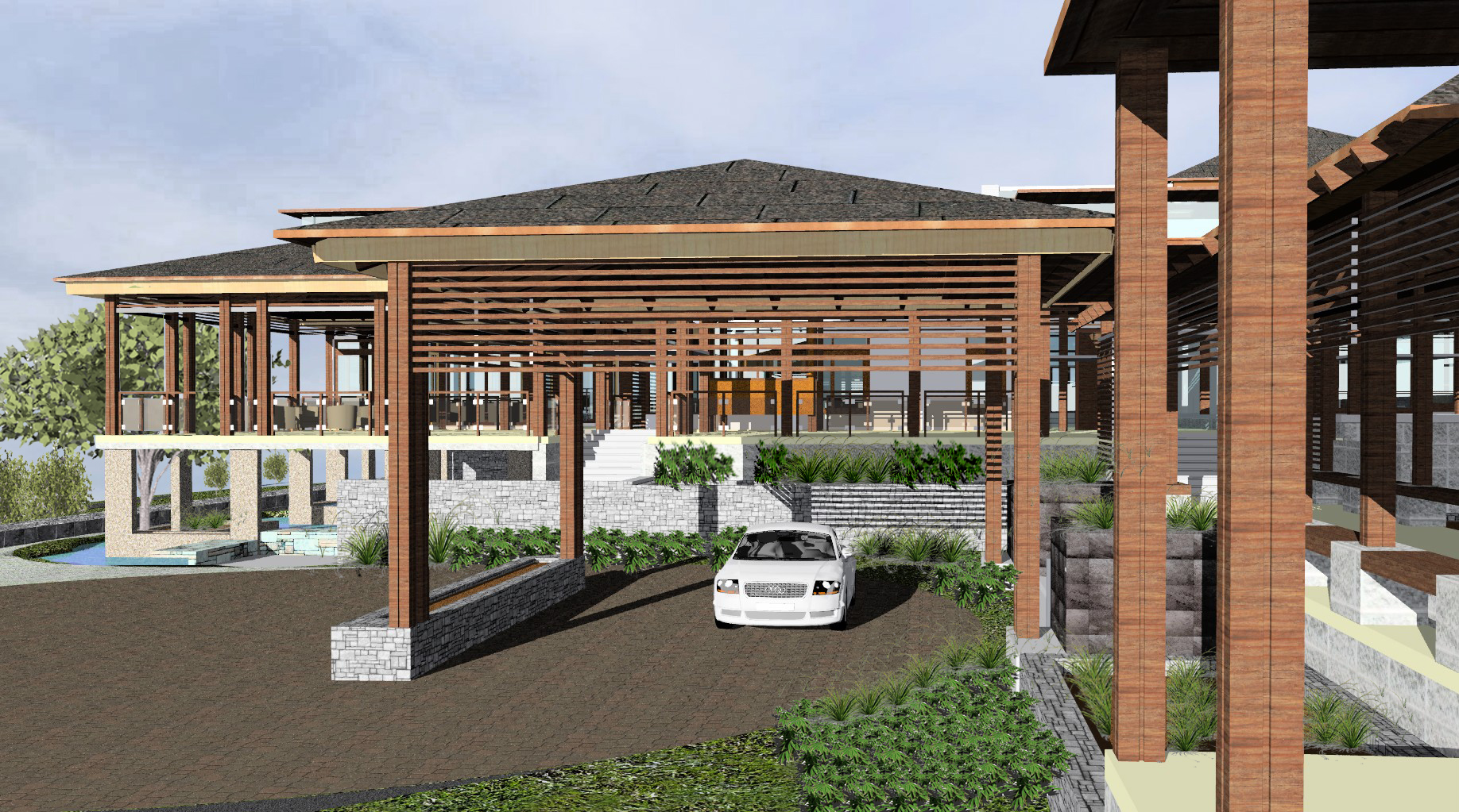

Cobra007
Joined: Tue, Oct 24, 2006
5 Posts
Thank you (KingRevit) for letting me know abt the revit 2009 release. The below image that am uploading is rendered in revit and later given some touch up's in photoshop...
