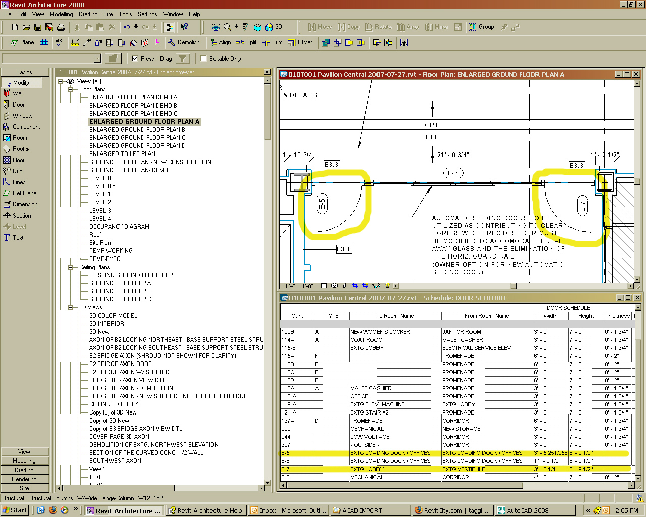

I have a curtain wall with 3 doors in it. The 2 outside ones are the same exact type, and the center one is a slider. The one on the right CORRECTLY shows the "to room / from room" of "lobby / vestibule". The other 2 doors show it INCORRECTLY. How can this be? I've checked to see if there are room-separation lines that might be messing with this, and I can't find any. Please See JPG I've attached. Please help!

To/from room information is sketchy at best when it comes to curtain walls.  I always have issues with it either not reporting the room at all or reporting a room that isn't even anywhere near.
 I can't tell from your screenshot where those rooms are actually located?  But if you want this issue fixed post it as a support request.  I've already had a similar issue which i've posted as a bug and it is scheduled to be fixed in a subsequent release... Hopefully.

Thanks for the reply. Yeah, I'm unfortunately noticing that most of my issues with Revit these days are legitimate bugs that i'm reporting with no good work-arounds. I think there are several things they can fix with the curtain wall tool.
