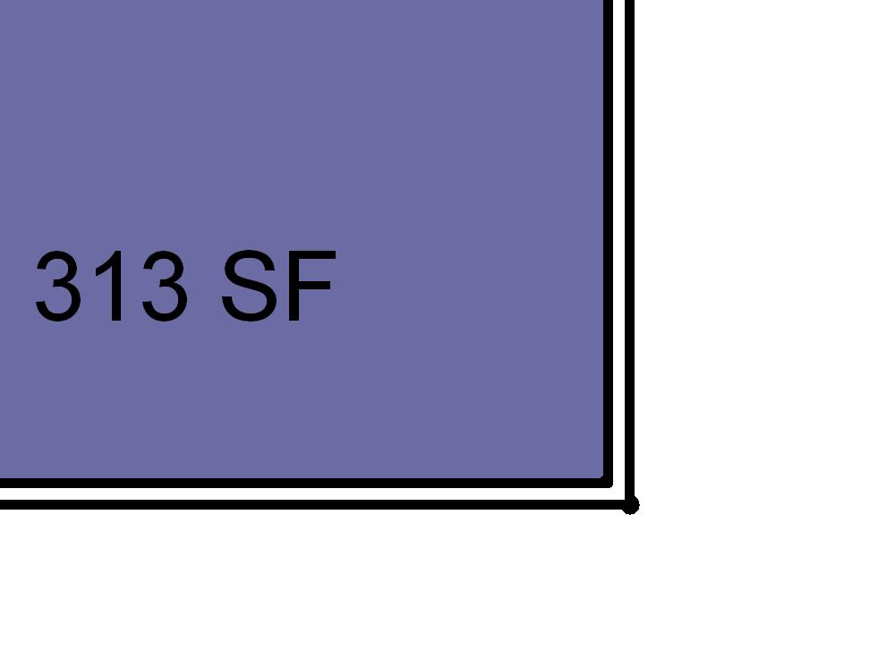

I need help!  I increased the lineweight of my walls in visibility graphics so I could quickly export some jpgs for a presentation...but in doing so it caused big fat dots to occur at all of the corners! What's wrong? How do I change it? Is there a different way I needed to do what I was trying to do?  I attached an image of what it looks like.  Thanks for you help!

Instead of using an override in the Visibility/Graphics, go to Settings - Object Styles, and change your Wall lineweight there.  I have no idea why the visibility/graphics override is giving you the dots, but I do know that changing your cut lines in the Object styles will work to give you a consistent lineweight.

The dots are depicting the "Projection Lines". In other words you are seeing the vertical edge created by the corner of the walls. Make sure you are adjusting "Cut Lineweight" for plan view and "Projection lineweight" for elevations. This should give you the result you are looking for. If you need to change the lineweights for all views then use the method of changing the object styles.
