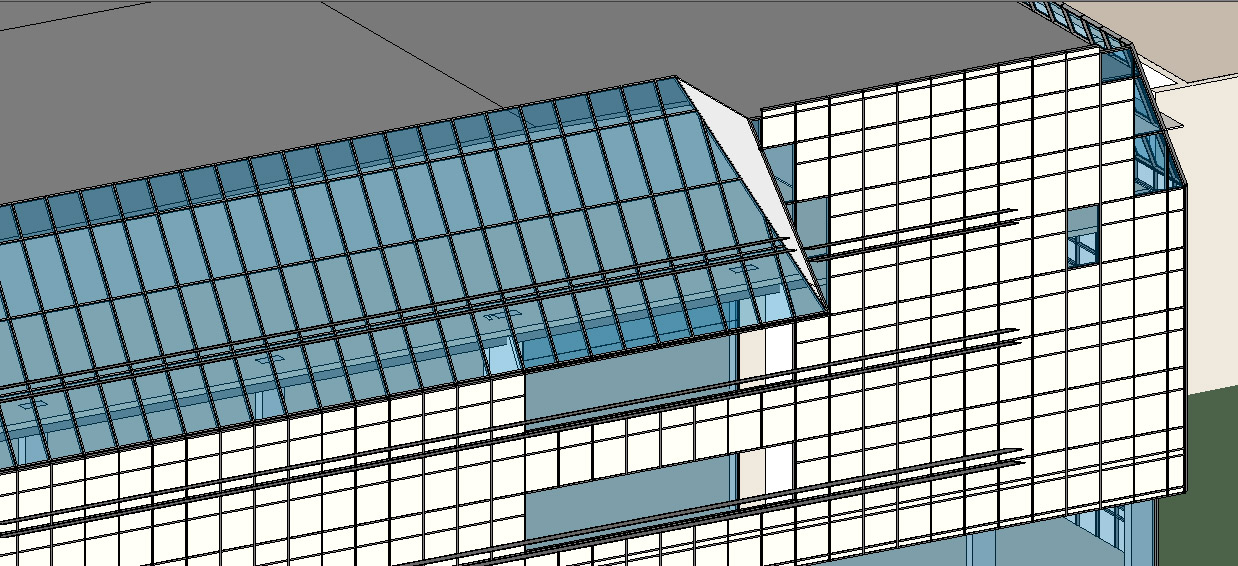

I've been creating curtain systems from a mass. The mass I've got doesn't  work with the metric standard curtain panel but it works with the default system panel. Where is the default system panel kept so I can copy it to make my own panels.
I'm hoping to make a Cutain Panel with a nested glazed panel, mullion and spandrel panel. Otherwise I have to individually select hundreds of panels, unpin them and change them to a spandrel panel. Any suggestions?
And/ or tips on doing glass panels and spandrel panels together (one ontop of the other) quickly?
Thanks

This is what happens when I do a custom curtain panel. It wont use the custom panel on the edges and where the panel is cut on an angle.
Refer image attached and custom curtain panel family.
Someon eplease help me.

Your image does not help discribe your problem.
I don't know if you can do what you want to do.  My suggestion is to create your gridwork then by using selection windows and filters, change the appropriate panels row by row.

Thank-you. I will do that.
Seams a bit odd that revit can't handle cutting the corners off the curtainpanel without diverting to the default system panel. Where is the system panel kept? Can I open it to duplicate it and edit it.
