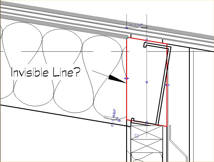

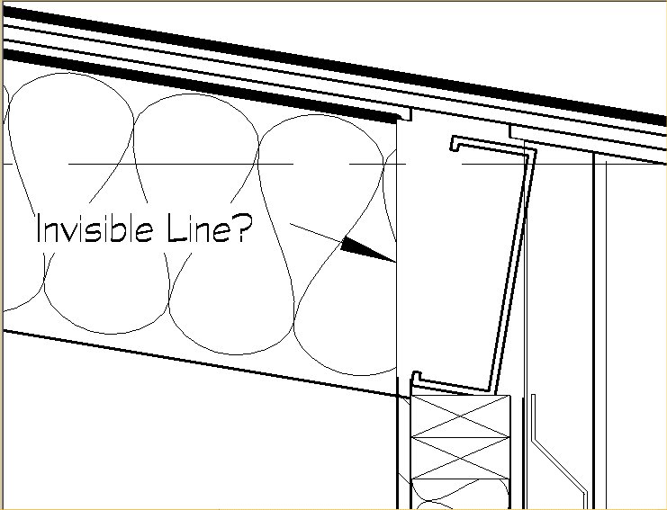

Fri, Aug 3, 2007 at 10:15:13 AM | Still have a problem with lines at the edge of masking areas.
Hogmodo
Hogmodo Avatar
Joined: Tue, Jan 6, 2004
367 Posts
3.5 Stars: 6 Votes
Attached are two images of a masked area with <invisible lines> selected for its outline.  For some reason, some edges still have lines and other edges don't.  Does anyone know why the insulation side of the area has a line still while the other sides don't?
Fri, Aug 3, 2007 at 10:23:38 AM | How do you eliminate the line showing around masking regions?
ArchWestCY
Joined: Wed, Mar 29, 2006
197 Posts
4.5 Stars: 7 Votes
That looks like the line below showing through.  It might be of a heavier lineweight than the Invisible Line.  Try moving your Masking Region's Invisible Line just a hair to the Left, and see if that doesn't cover it up.
ArchWestCY
Fri, Aug 3, 2007 at 10:33:58 AM | That was it! Thanks for the help.
