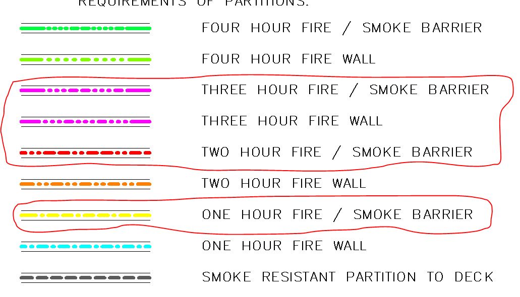

I am having issues trying to find/make a (1 hr fire/ smoke barrier, 2 hr fire/smoke, 3 hr fire/smoke) pat.

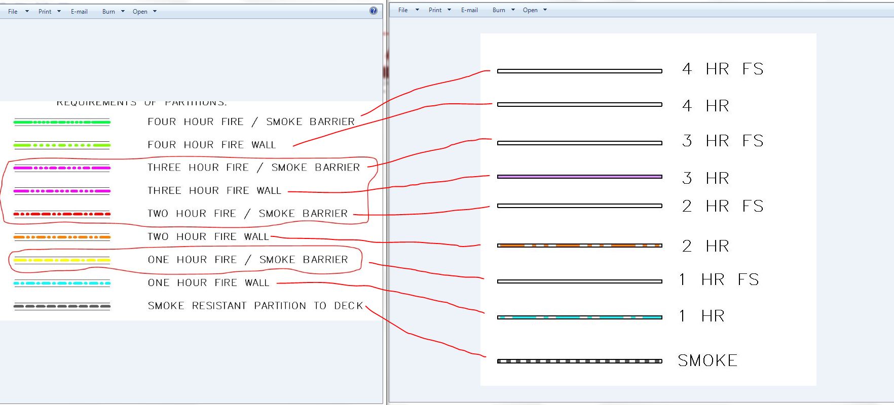

Well i would like to have them as a pattern like the image attached. I am trying to have them look like the lines where the patterns have the correct spacings similar to the lines.

May I offer a suggestion?  Patterns like this will probably never work.   Walls are not all horizontal like your image.   They are at all sorts of angles and even arcs.  Even in Cad, this can not work.
We create a fire rating plan where all of the mode, architectural elements are screened.   Then we add the appropriate linework along the center of the walls to indicate the rating.   This is still fully BIM because our walls are tagged in the model with an appropriate tag that is scheduled for the correct rating and shown in the wall legends.

NO!   I would never use a model line here.   This line is only meant to show in one view and does not need to be scheduled.

As WWHUB said, doing this as a pattern instead of a line type would essentially be impossible. The best practice is to do it as a detail line (not model line) and draw it along the centerline of all your walls. Line patterns in revit can support a repeating pattern of up to 10 differing line lengths and spaces and in your image the most you need is 6 with the 4 hour fire wall/smoke barrier which has 2 lines and 4 dots repeating.
