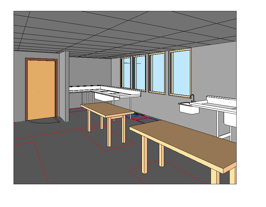

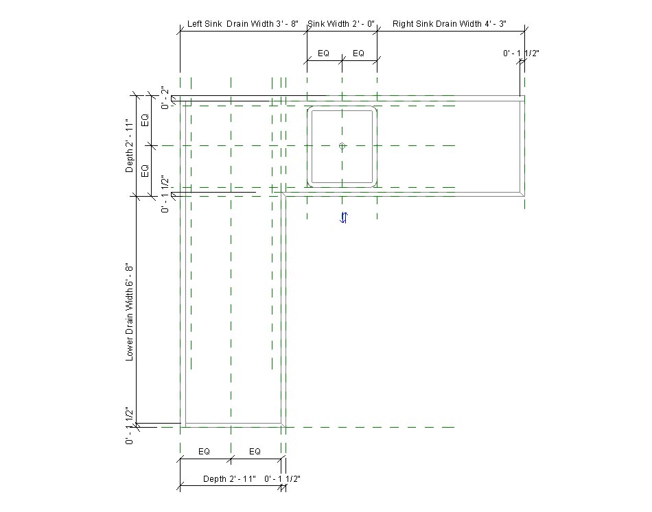

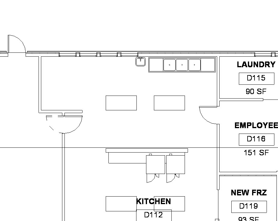

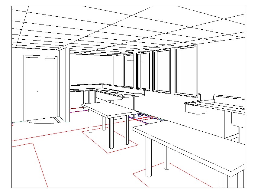

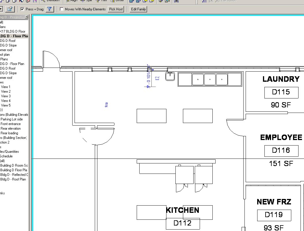

Its a counter top for washing dishes.  It took a long time to make even though it is just a modified version of one I downloaded.
It shows up in 3d views and Elevations, but not in plan.  Is there something i did wrong or do i have something turned off?
 here are screen caps i made to show you what i did.
25989_Hidden_Counter_01.jpg25989_Hidden_Counter_02.jpg25989_Hidden_Counter_03.jpg25989_Hidden_Counter_04.jpg25989_Hidden_Counter_05.jpg

When you are in the family editor, did you check the family element visibilty of the countertop to make sure the plan/rcp is checked?
Wed, Jul 25, 2007 at 1:37:34 PM | JHanby
Atomsk
Joined: Mon, Mar 19, 2007
39 Posts
5 Stars: 3 Votes
Quoting JHanby from 2007-07-25 12:20:03
This work!  why would that have unchecked itself?
