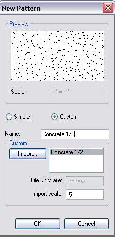

Hi Chris, Concrete fill pattern (drafting) appears to be designed for a 1”=1’ scale and does not appear to be rescale able. I wanted the cut pattern in my sections to be correct at 1/2”=1’. I copied the concrete text out of revit.pat and copy/pasted into a new file concrete 2.pat and renamed it concrete 1/2 in text header. Then imported and scaled this pattern as concrete 1/2. Sam Post edited on 2005-12-08 10:35:01

That's correct. No custom pattern in revit once imported is re-scaleable. To change the scale you need to re-import it.
