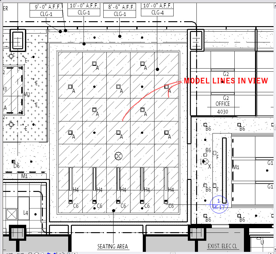

Hello,
I'm using Revit Arch 2008, and in my floor plan I have multiple hidden (model) lines.  They show up on the sheet layout, but when I print to our plotter -- some of them disappear and do not print.  However, when I printed the same sheet layout to a pdf, all of the lines are visible.  Any ideas on what the problem could be?
Thanks

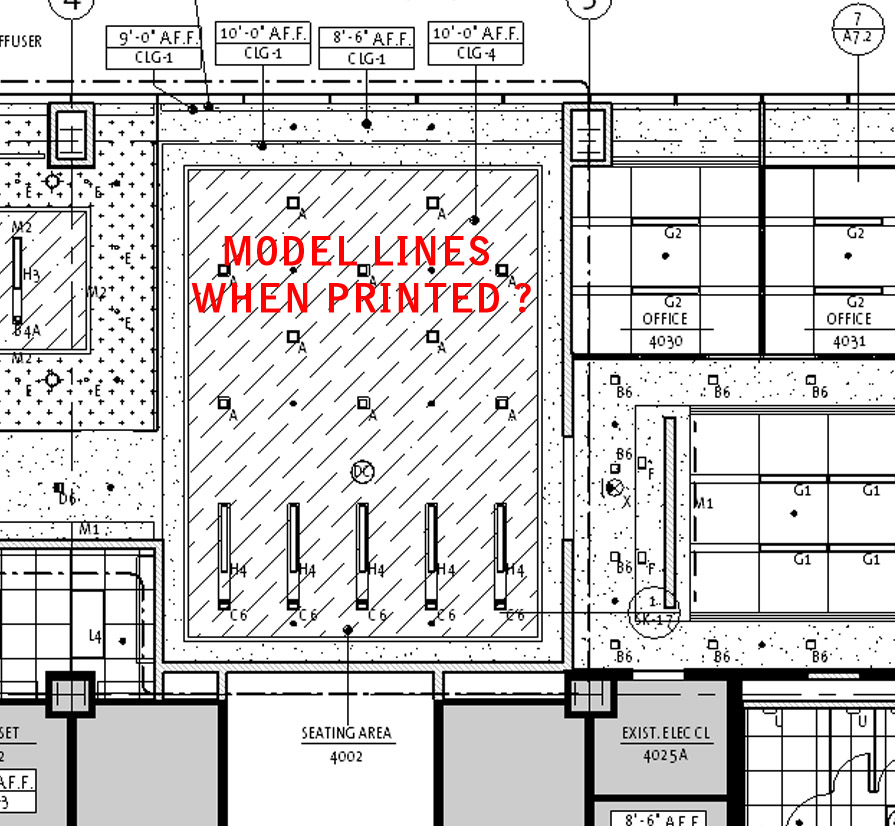

Same here. Model lines (both solid and dashed, no matter what the line weights are) on brick walls don't print but the ones on different walls do print. Anyone can help us out? Many thanks.
They print under raster processing setting though.

I have a file that was started in 2008. Used model lines on ceiling and wall plans. They were visible both in the view and when printed.... Now we upgraded to 2009, same file, the model lines are visible in the view but are the only thing that dissapears when sheets are printed.    I have searched printer settings and visibility settings.  PLEASE HELP THEM PRINT.

Are you using vector or raster processing?  Vector may work better with the thin lines.

The funny thing is I am using Vector printing, and when I print in raster they show up.  Some people consider this a reasonable workaround but it makes the pdf's far too large to send to consultants and the line quality isn't as sharp.
