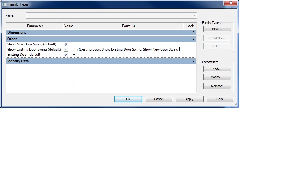

this is an older thread but exactly what I am trying to do ... I have a family that will place an arch for a door swing but if the door is defined as EXISTING, then the arc is replace by a straight line.
The statements I have tried are:
  1. if(Existing Door, Show Existing Door Swing, Show New Door Swing) ... or
  2. if((Existing Door),((Show Existing Door Swing) NOT(Show New door Swing)),((Show New Door Swing NOT(Show Existing door Swing))
If you view the attached image you will see my parameters and my current attempt at the IF statement.
  • Existing Door - a shared parameter that will the the controller for this item.
  • Show Existing Door Swing - the visibility of the straight line is controlled by this project parameter
  • Show New Door Swing - the visibility of the arc is controlled by this project parameter
The error I receive refers to 'circular' errors or 'Function' errors.  I suspect that it is a simple syntaxt issue ... can someone take a look and offer a suggestion?  My goal is to have a single check box that will control the visibility of the 'existing' and 'new' graphics, and to be able to schedule the results.
thanks in advance ...Ian

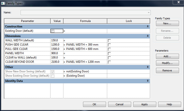

You're over complicating it. Get rid of the Show New Door Swing parameter, you don't need it. Use the Existing Door parameter to control the visibility of the existing door linework. Show New Door Swing formula, use 'not(Existing Door)'. I also like to place parameters that are not user controlled (Show New Door Swing in this case) in the Other category, it seems to keep people from trying to use them.
BTW, the 'circular reference' error is coming from using a parameter in its own formula.

Thank you for your assistance.  I was able to get my family to work.  Despite your suggestion, I decided to keep the parameters I had, but your guidance for understanding the boolean operation was invaluable ... many thanks.
The shared parameter Existing Door 'drives' the process and schedules nicely.  I have attached an image of the Family Type dialogue.

Why keep the extra existing door parameter instead of just using the one? There's nothing wrong with doing it that way (it's obviously working fine), it's just an extra parameter that you don't really need.
