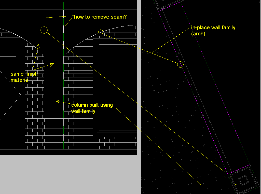

I'm having a bit of a problem with arches/columns.  Can't figure out how to combine them properly.  Note: my column is actually a wall.  See attached image, should explain in a bit, if not, let me know

Same materials in the same plane can be joined using the "join geometry" tool.  (Overlapping squares next to the offset button.)

Thanks for the info.  I did some testing and figured out why it happened.
The arch and columns were aligned at an odd angle, something like 68.859.  Due to that angle, I think some of the snaps were off a bit when i was modeling the column.  I chagned everything to an exact 67º, redrew the colums & arches, now join geometry tool works fine.  thanks again
