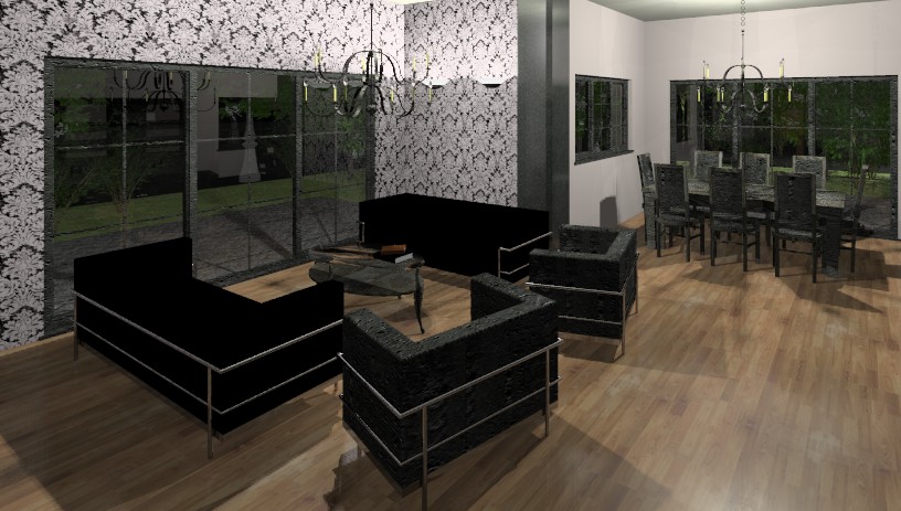

by the way' what do you think of the image i loaded? its the second model im creating in revit
Wed, Jul 18, 2007 at 12:27:29 PM | changing material of component - doesnt affect when rendering
Looks like your getting the hang of it.
    - It looks like your windows may need some work yet.
    - You may want to put a studio light some where behind the camera
Looks like you may have some families (like the chandelier) in here that would be nice to share with others on this site.  Can you do that?
