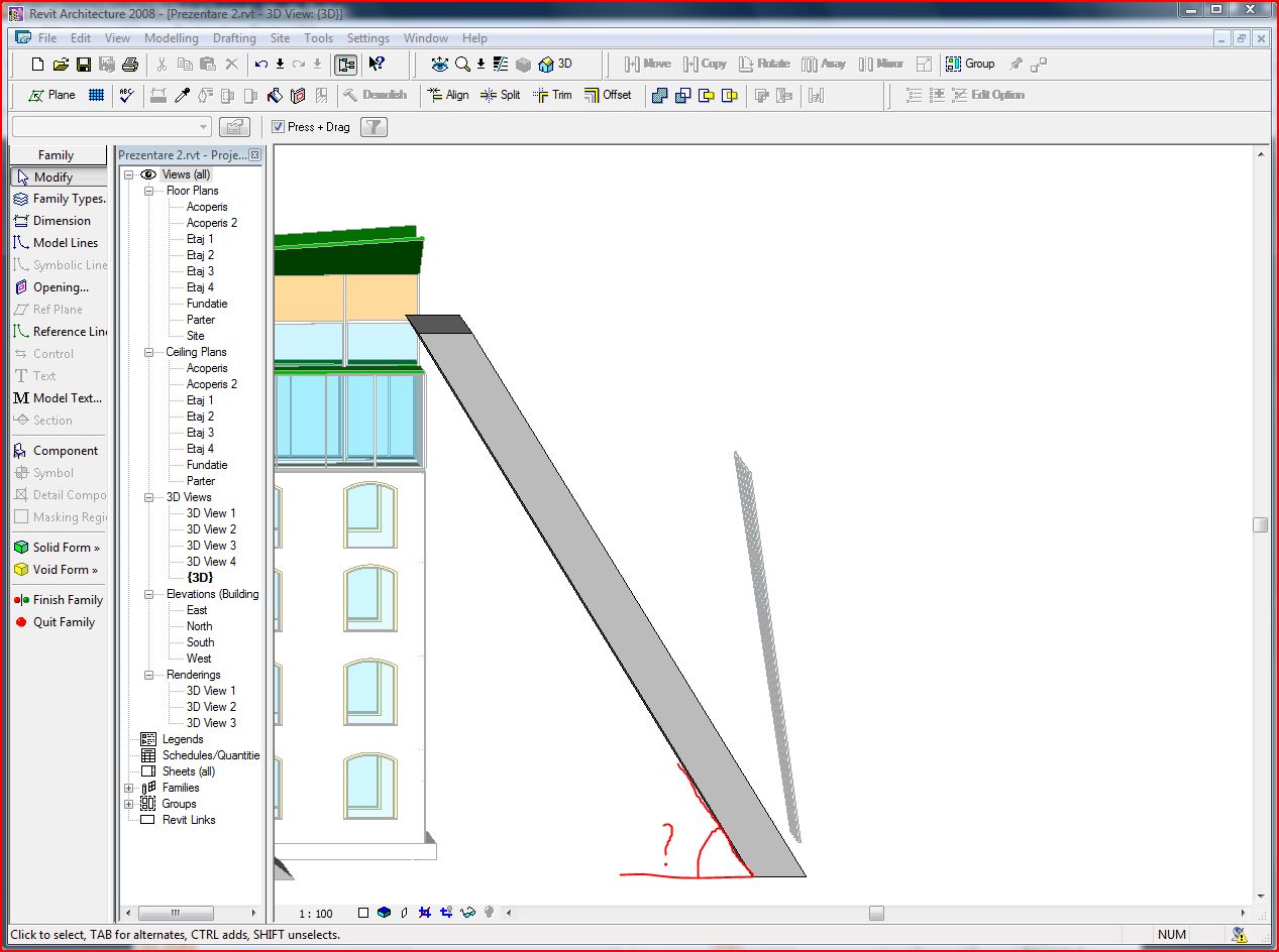

OK, so I made a family of an inclined wall and I want to make the angle of incline an editable parameter.
How do I do this?
I attached a picture of what I already did.
 Thanks!

THe process is the same as adding a parameter in a family.
Draw a reference plane at the desired angle.  Add a dimension and instance parameter for the angle.  Then constrain the wall extruded sketch to it.
Alternatively though I would do this with a mass so I can apply a standard wall to it using pick face...
