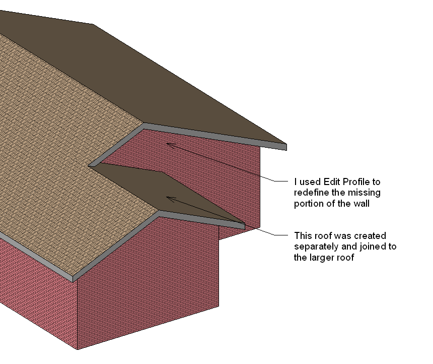

Revit people, hi!  I'm working on a residential set of plans and I have a few questions;
  1. How do you do a wall fill between two roofs, with 5:12 pitches, but not going all the way down to the floor below?  The roofs are pitched, and the walls are at an angle?
  2. The default siding (out of the box) is horizontal planks - I wanted vertical!  where do I rotate the siding 90 degrees?  Or do I download from somewhere else?

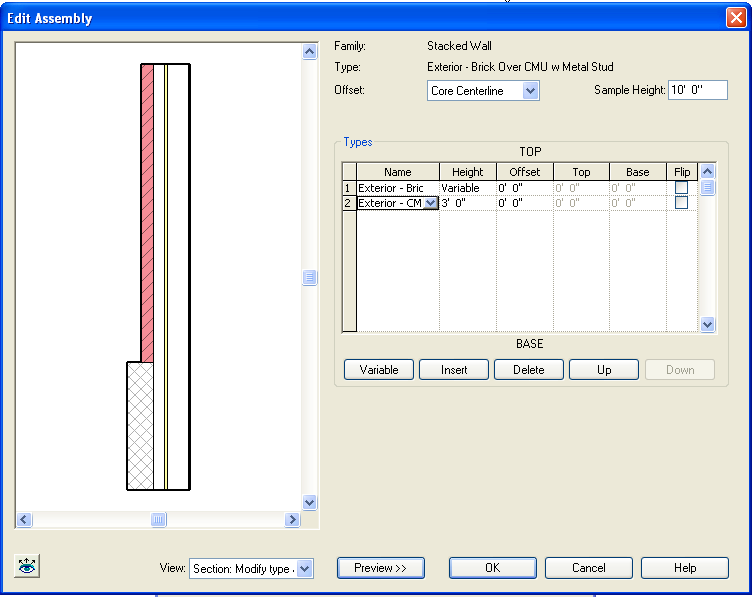

  3. The downstairs siding is actually two materials.  The plaster goes up about half way up, and on the top half of the walls, are vertical plank siding to match the upstairs.
  4. There's a slight arch ( R = 9' - 0"Winking at the roof and downstairs wall.  They are 90 degrees to each other.  How do I draw an arch at the end of a wall or roof?
  5. This one is tricky because there is a curved entry roof, and I don't know how to add that.  It comes out a few feet over the top entry step.
  6. And finally, how do I get the siding to come down over the flooring?
I'm fairly new to Revit and I have the latest version, Revit Architecture 2008.  I've included a 3d view of what I'm working on, it's a .dxf and I'm new to that too.  Let me know if you have solutions for me.  Thanks in advance.

These are a nice set of questions. I will try to help in any of them that i can
1. You can do this a couple of ways. You can use "Edit Profile" on the adjacent wall and fill in the missing area, or you can draw a wall on the second level and attach to the larger roof.

3. For this you can create a stacked wall with the plaster at the bottom and the siding at the top.

5. This will be acheived by doing a roof by extrusion and then joinin the two roofs.

1. The one that has the wall already there I would edit the profile. The one in back I would make a new wall, doesn't have to be anything pretty, go to elevation, raise it up to a decent level, then edit your profile. I personally try to stay away from joining the walls to the roof. I seem to get myself into more trouble than not with that method.
3. If you are just drawing and not need any type of materials list, an easy way is to use split face, then paint bucket in your texture/hatch/fill pattern you'd like there. It's quick and easy. Doesn't really duplicate real world sometimes though.

  3. I don't understand "stacked walls".  I didn't see a stacked wall option,  I'm assuming I must draw to seperate walls on the bottom floor to get the stacked wall option?  This is also where I must "flare" out the bottom of the downstairs wall.

Stacked walls are one of the three main wall families (Basic, Curtain, Stacked). They allow the user to create vertically compound walls and draw them as one unit. This is useful for things like Partial Height Cmu kneewalls with a stud/EIFS wall above. The only way I know to create one is to duplicate and modify the default stacked wall that comes with the templates. What you do is define the different walls that make up the compound, then you define how far each on goes up the wall. I know this is confusing. I have attached a screen shot of the properties of a stacked wall. HTH
The problem with the roof/walls is that the sketch lines represent the both edges of the two roofs even though they are not on the same plane. To correct this you will have to create the roofs seperately and join them. (See IMAGE 1)

Okay, I got the stacked walls.  That was easy.

The way i created the model in my above post was to first create the larger roof using pick walls and giving it an overhang of 2'-0". I only picked the walls that make up the larger part of the building (I left out the three walls of the extended part). I had to use Trim to connect the sketch line for the common rear wall and short wall. This resulted in a roof over the larger part of the structure but not over the smaller part. I then created a roof over the smaller part in the same way and allowed the sketch line for the connecting part to align with the face of the larger wall. This resulted in a smaller roof over the smaller part of the building that extended into and under the larger roof. When I used Join Geometry, the common surfaces became one.
I do not know if this is the best method, its just the one I use when I come across this situation.

Your image is exactly the problem I'm facing.  I did edit the profile of the wall in elevation view, and then added a new roof in plan view.  I then combined the two roof surfaces into one surface.  The view does look correct now.
