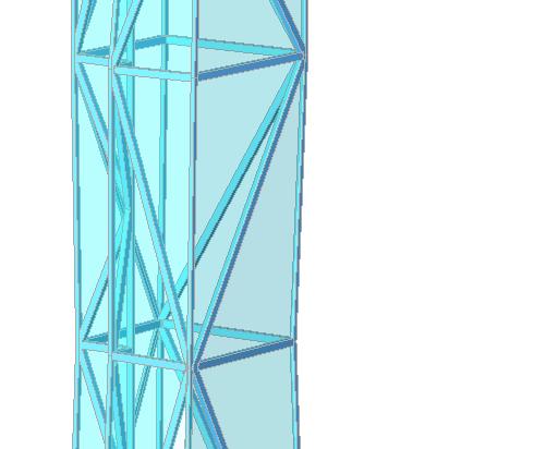

I'm using Revit 9.1, and I've inherited an architect's building model.  Trouble is, I need to replace the skin, and I'm having difficulty doing so.  The building is composed of a series of inclined walls, framed by a structural exoskeleton.  I want to be able to create either a roof or a wall in Revit for each section of wall in the building, but I can't seem to make the elements join correctly.  It's a hard problem to describe, but perhaps someone can understand where I'm going, and has a suggestion.

If they are inclined walls, they very well may have been created using the mass tool. Turn on massing (the little ble cube in the toolbar) and see if there is a mass defining the shapes of the walls.

Yeah, there is a mass that can define walls.  When I attempt to apply walls to the mass, though, the created walls overlap with the solid structural frame, and since they are inclined or oblique walls, I can't figure out how to easily edit them to fit the frame.  I'll try to get an image up (I'm just hesitant because this is semi-sensitive material).

Alright, here's an image.  I want to be able to infill each of the triangular sections with a curtain wall skin, and achieve an accurate boundary with the structural frame...

You'll need to use the edit profile on the curtain wall to create triangular pieces as required.

"Alternatively you could use voids to breakup your mass around the structure so you can then place curtain walls by face to the individual faces as required."

It all looks like alot of work. I hope that you can see the "exoskeleton" from outside, ie. the skin is glass. Otherwise it seems to be  a very onerous way of modeling.
I am not saying that this applies to you...but many people seem to forget that this is primarily a documentation/ concept architectural program and not a modeling program. Consequently I see alot of people wasting time on overly complex modelling that is not required to get the idea across to a client or builder.
If this model was for a 3d render there are many much easier ways to get the affect you are after using texture and opacity maps, rather than physically modeling it.

yeah, I'm just trying to get an accurate skin takeoff, but it doesn't seem like there's an easy way to do it.  i appreciate the input.
