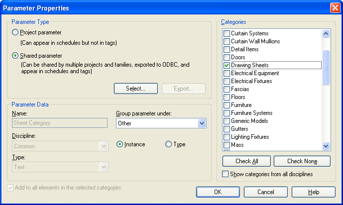

Go to Settings-->Project Parameters, click "Add". In the next dialog box there will be some categories on the right-hand side of the box. Check mark the one that says "Drawing Sheets". I have attached an image depicting what I am talking about.

Ah...
Thanks James
