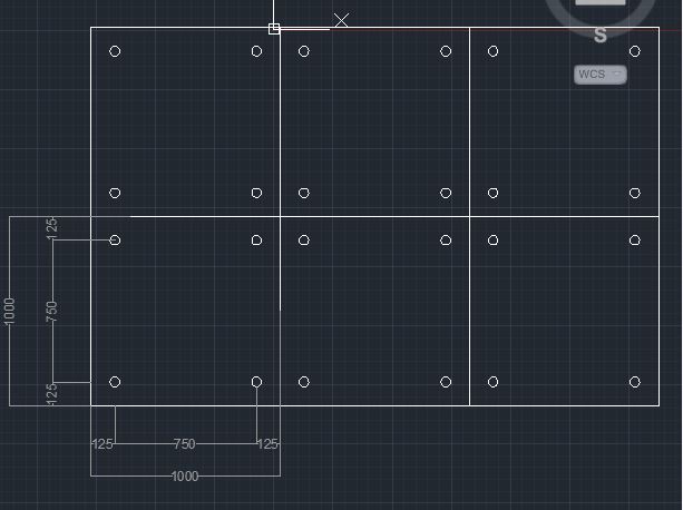

Hi, anyone knows how to do this hatch pattern? (see the attached) This is a casted concrete wall with recessed botton on 4 sides.
Is this possible?
Regards..

I would never do this as a hatch.
What this "pattern" represents might determine what I would do but you don't tell us that.

Try this - it's two unbounded lines at right angles and four approximated circles generated by HatchKit 2014.
