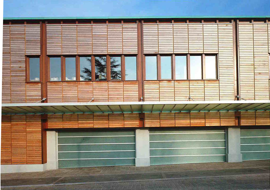

I created a curtain wall panel of a wall assembly that i'm trying to render.  I've attached it, along with a picture of a precedent.  It is meant to be along a curved curtain wall meaning that the grid on the curtain wall produces some full rectangles and some that "run off" of the edges  My panel won't place in the "runoffs", but a simple panel such as a solid or glazed will.  Has anyone haad any experience dealing with this issue and if so had any luck correcting it? I'm afraid I might have to start over with my panel and simplify it even more by using the solid panel as a template.
