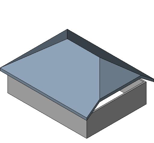

Does anyone know how to make a partial Hip roof?  Im not sure if thats really what its called, but its just a hip roof that has a small hip at the top ridge of the roof, but then changes back into a gable look.  Somewhat like the attached picture.

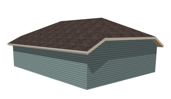

Hi I tried this in revit 2008, I created a roof by footprint, drawing the lines, I didn't check if it is the same when you pick the walls, then I split one of the sketch lines in three places, I unchecked the "defines slope" for the two corner ends and the center line I left it to define a slope and I changed in the line properties the offset for that line from the roof base level, let me know if this is clear enough, good luck

That works, thanks.
