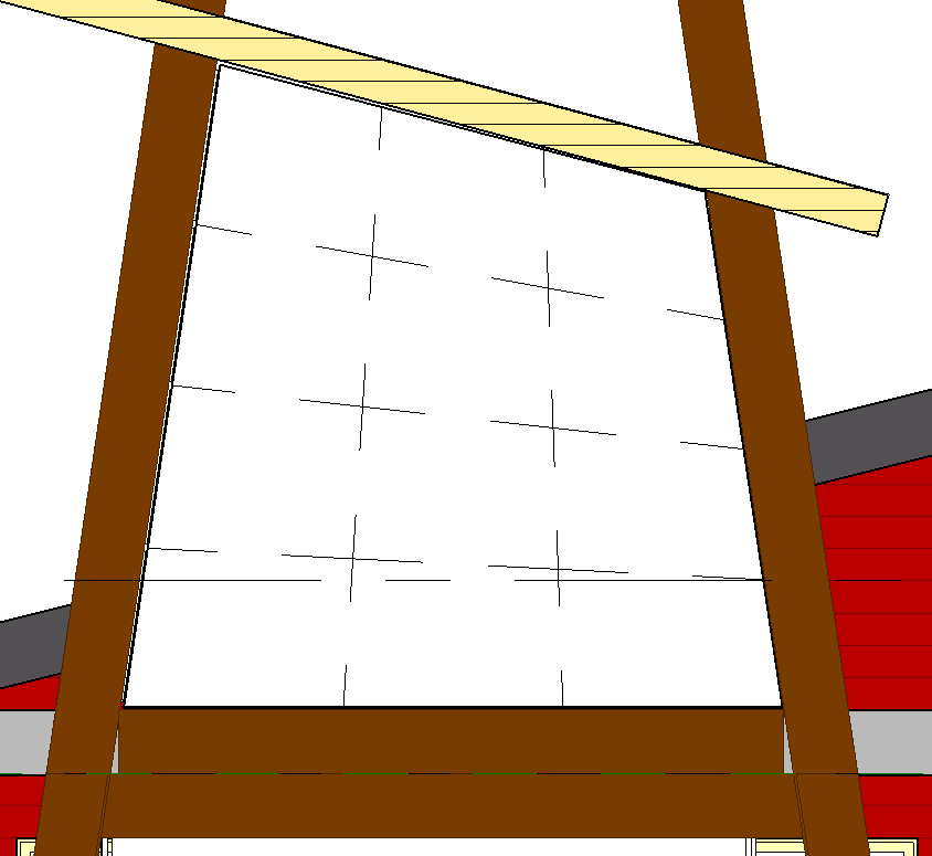

Hi, I have a trapezoidal shaped curtain system that I am trying to put a curtain grid on it that is all right angles. The curtain grid is automatically slanting the grid lines according to the points on the other side of the object. Attached is an image of what I am talking about. Please help. Thanks.

Can you try it using a Wall:curtain wall or Wall: Storefront...available under the WALL button?

No, because I made this in-place wall family because the glcurseis infact tapering in as it goes up, so I couldn't use one of the wall presets.

oh...then create a mcurseelement that fills the hole in your wall. Now you can add a curtain wall system by face to the mcurseelement and use a Type-Driven Curtain Grid Layout. Check help for this topic "Type-Driven Curtain Grid Layout". Should be able to do it then... Post edited on 2005-01-13 20:40:26

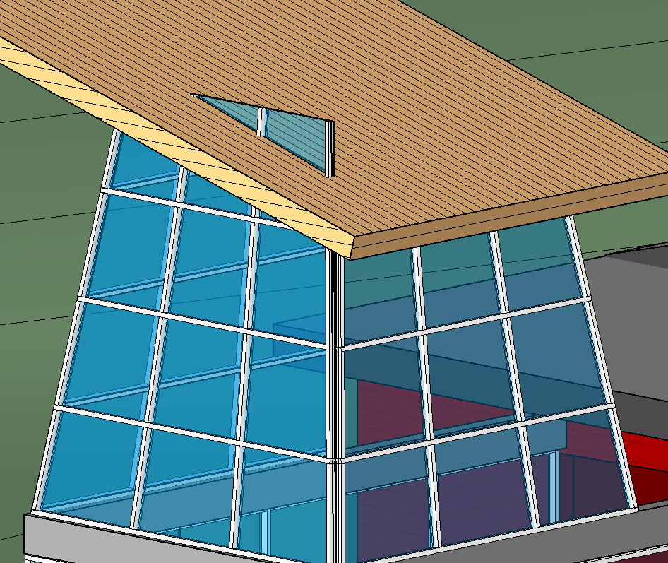

Ok. I have figured out most of the model and I have an orthagonal curtain grid system, but this is because i need to trim it to form to my roof. Attached are pics of the curtain wall sticking out of the roof. I need to trim this wall to the underside of the roof, and it is an in-place wall family, not a wall, so I cannot just Attach it to the roof. Please help.

a 3d image.
