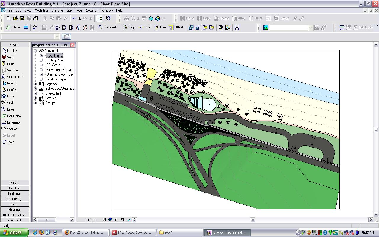

 i understand the reason of BIM tech with autocad... i m working with ur tricks i'll let u know if thats work.... here i m attching my site plan with it if u have any more suggestion how to domension it.... i'll be glad and i owe u big time
