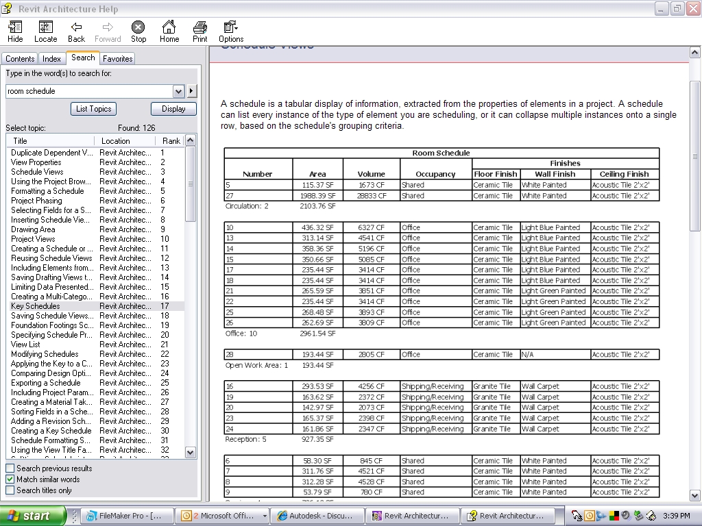

Can someone help me understand how to format a room schedule like the example I attached here?  How do they "stack" Finishes over Wall, Ceiling and Floor?  It appears as though there is some sort of category and sub-category.  Thanks

To group colums together you select the columns that you want to be under a single header, and then on the bottom tool bar click "Group" next to the properties.  You should see Headers: "Group" and then some grey out ones.
