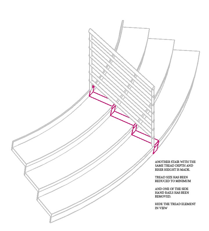

I am designing an aluminum football stadium seating. How do I create a sloped guardrail to prevent people from falling off the side and to also be used to this to divide the booster club sections from standard seating? (See Image attached) I know how sloped rails are auto created with ramps or stairs, but in my case the rail is independent of those. I attempted to host the rail to the side of the beam then I created a sloped reference plane and tried to host it to that also. Please help. Thanks.

From what i have seen Railings can only be  hosted to stairs and ramps.  To make one that is sloped and not hosted you would have to create a railing in place by hand which is very time consuming.  I would suggest if you have a football staduim you should put actual stairs in where you have an isal (sp**).  Thoes really are the only 2 ways i can think of.

You have a couple of choices that will work.  If I undersand your project, you have stepped seating area with railing on a slope to match.
You could do the area where the railing is as a stair with big treads.
But railings can also be hosted by floors so I would probably go that route if your floor is the traditional concrete with a sloping bottom and stepped top.  To do this, just model that portion of the structure that is uniform thickness as a sloping floor and host your railing on that.  The steps could be seperate flat floors joined to the sloping portion.

IT IS FAIRLY SIMPLE TO DO A SLOPED RAILING ON A CUSTOM MADE STAIR OR STEPS.  PLEASE SEE ATTACHED JPG.

there is al so the option of making it as an inplace family
