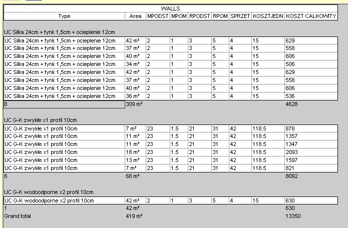

i was just hoping that i'm wrong Puh cause its weard a little bit for me that i can't put cost parameters into a wall family.....
with schedules, there is a little problem, see PIC1.

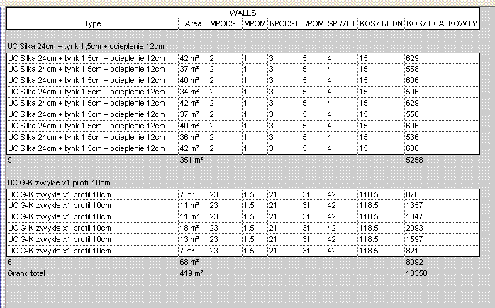

its a schedule with costs included, it looks ok, but when I change one of the wall types, costs stay the same...... Puh see PIC2

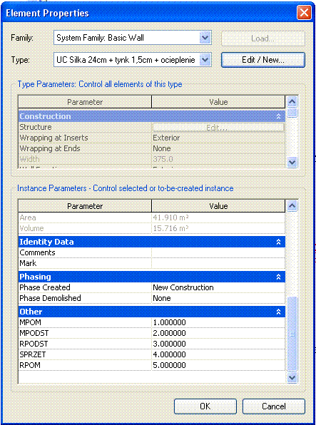

now see PIC3. you can see that all my cost parameters that i put in the schedule are now in my wall familly, i hoped that
when i put the costs in here thay will show in all walls of this type.....i was wrong Puh when you type them here they will only
show in that one element.

cost is the last column is the sumary cost of all included costs. it is calculated automaitcally. but this is not the problem. see the diffrence between PIC1 and PIC2. I changed one of the wall types but the summary cost is still the same.
