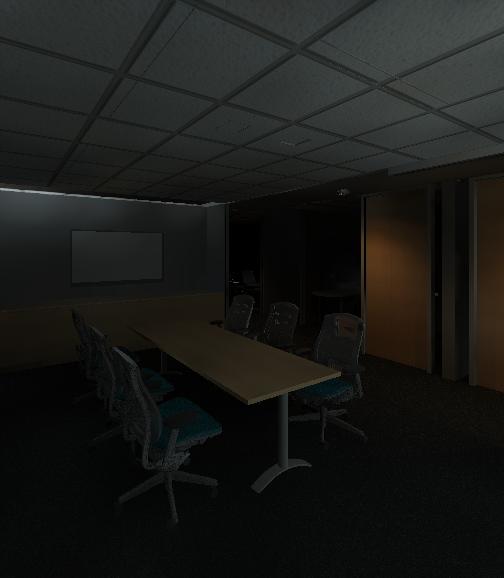

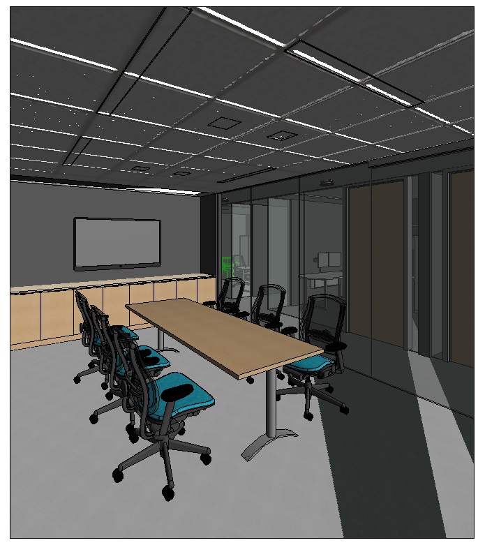

I am having a similar problem- my recessed lights do not cut through the ceiling - you can see in the 3D views
Also this light has no IES available- how do I get this to emit light?
I am using revit 2017

Do you own the ceiling or is it a linked file?  A face based family will not cut a hole in a linked ceiling.
I did not open the light family but here are some thoughts.  Some light families do not cut a whole in their host (if they are hosted at all).  Not all light families light.  Even when they do, you may only see the lighted objects the light is cast on but the light itself may not show, it has to be built with a self-illumination material.  Lights only show in rendered views and only when they are turned on.

the ceiling is not a linked file it is just a ceiling grid I drew in my model- I think I can figure the emitting light problem later but the cutting through the ceiling has me stumped - I have edited the family and checked the box that says cuts voids when loaded. What am I missing?

We don't draw ceiling grids.   We assign a material to the ceiling that includes grids.  Your lights will never cut your lines.

Standard process is to define a ceiling that has the material in the ceiling definition, not applied afterwards.  Either way, if your light is not cutting the ceiling and IF the light is hosted by the ceiling, then your likght was never built with a void to cut the ceiling.  The void must be in the ceiling family and set to cut the host.
