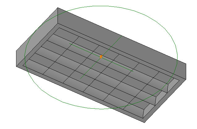

I have been using VE for a while in conjunction with Revit. Solid program, easy to use, better that e-quest. as far as lighting goes that is where i started. very useful since revit only give you a zonal cavity calculation. i attached a generic room i did with some cooper lights it took me about 5 min to set up and another 5 to run the calc on medium. as far as the life cycle cost analysis, thats where the fun begins Smile

Thu, Apr 24, 2008 at 11:42:23 AM | Revit and IES Virtual Environment
Eddieboarder91
Eddieboarder91 Avatar
Joined: Mon, Jul 16, 2007
237 Posts
4 Stars: 8 Votes
It might have helped if i grabbed the right image.
