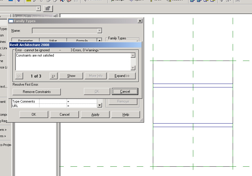

Hi, here comes my second post. I try to set a integer parameter for my window muntins or mullion.. doing array, add label, and test the flex, all fine. Then I align the edges of each muntin to ref plan of the edge of window and lock them. Then when I try to flex the window width, I got a error message (see attached image). I'm sure it shouldnt be like this, which step I got wrong or missing? please help, thanks in advance!

Expand the error, look at the ID# of the item giving you the problem, write it/them down or copy it.  Click cancel.  Go to Tools > Elements Ids > Select Element by ID.  Enter the id number.  It will hilight your problematic element.  Usually when I get this error I end up needing to re create the element that is causing the problems.  Another helpful thing when dealing with constraint errors is to turn on Automagic Sketch Dimnsions.  This can be done in the View Graphics dialogue (Type 'VG') under the Annotation Categories tab.  Expand Dimension and check Automatic Sketch Dimensions.  Check to see what constraints Revit is putting on the element causing the problem and you can unlock or change the dimensions as needed.
