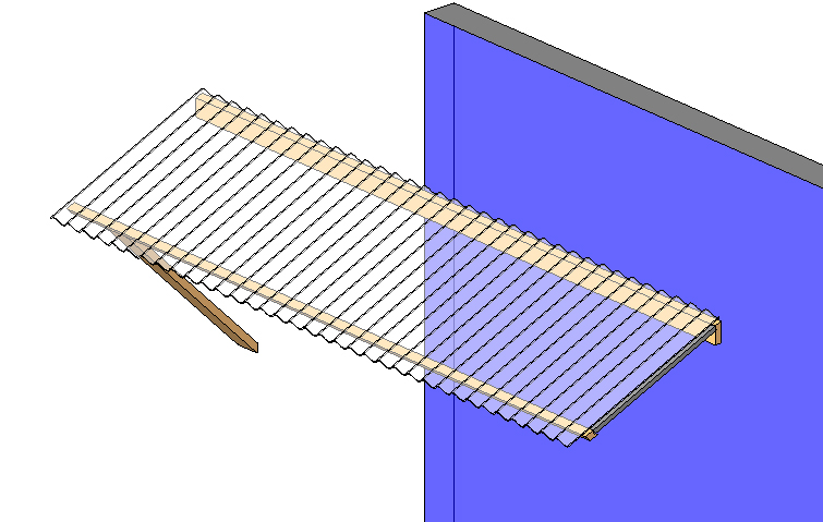

how to create a corrugated roof and how is the best method?
We used sweep to create the corrugated roof, but I can't control the lenght of the shape.
I will attach a jpg of the roof.

Sat, Jan 17, 2009 at 6:29:00 AM | corrugated roof
tim123
Joined: Tue, Apr 12, 2005
1310 Posts
4 Stars: 19 Votes
There are a few ways to achieve this if you really need it modelled.  You could use sloped glazing and insert curtain wall panels with this profile.  Alternatively, look at this site: http://revitfamilies.blogspot.com/ for another method using the structural beam system.

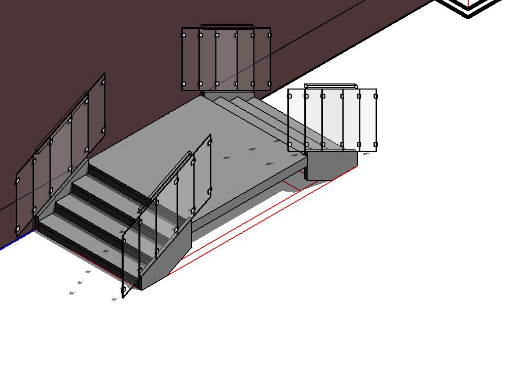

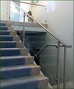

Wed, Jan 21, 2009 at 5:39:27 AM | corrugated roof
#10
audyr1
Joined: Wed, Nov 26, 2008
6 Posts
4 Stars: 1 Votes

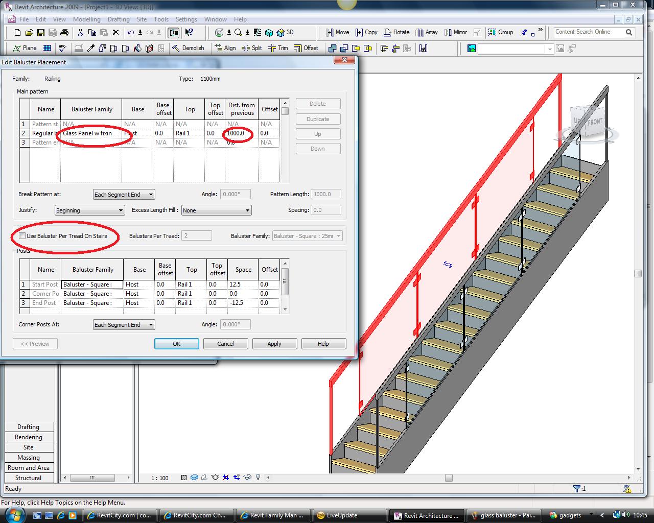

n d nxt image i.e (handrail 2. jpg) or (1029.jpg)  is what i was looking for....
thanks
Wed, Jan 21, 2009 at 5:53:06 AM | corrugated roof
#11
tim123
1310 Posts
4 Stars: 19 Votes
Hi
See attached image - it shows the glass balustrade inserted into the stair.  You need to get the spacing right and ensure that you dont have baluster per tread on.

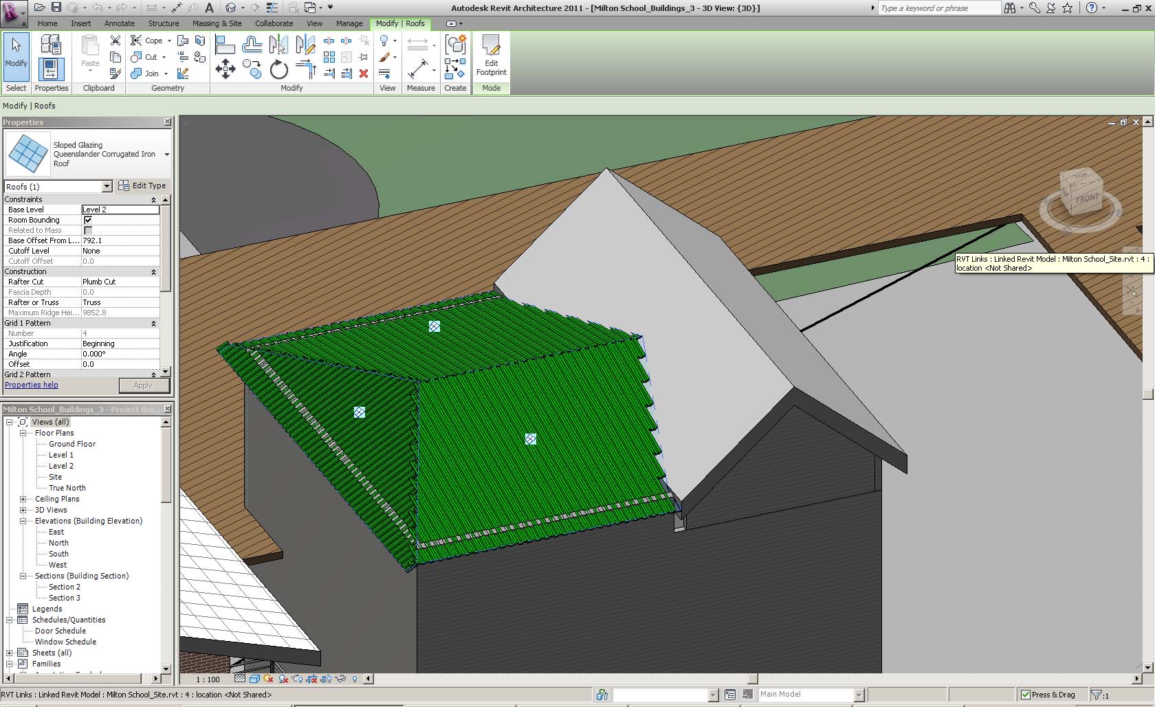

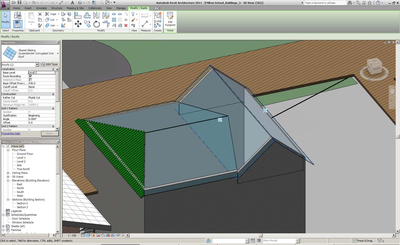

Fri, Jul 29, 2011 at 8:53:10 AM | corrugated roof
#12
DSArchitect
Joined: Sun, May 29, 2011
18 Posts
5 Stars: 1 Votes
Hi all
I am currently working on a project where I need to produce an iron corrugated roof for a Queenslander Style house. I followed the instructions given in the video suggested by Typhoon, however it doesnt seem quite right.
There are 2 main issues:   - How do I ensure the walls below aren't showing through?   - If I try and make the second portion of the roof into the corrugated iron, it just turns back to 'Sloping Glazing'. How can I rectify this?Appreciate any help you can give me. ThanksDS
