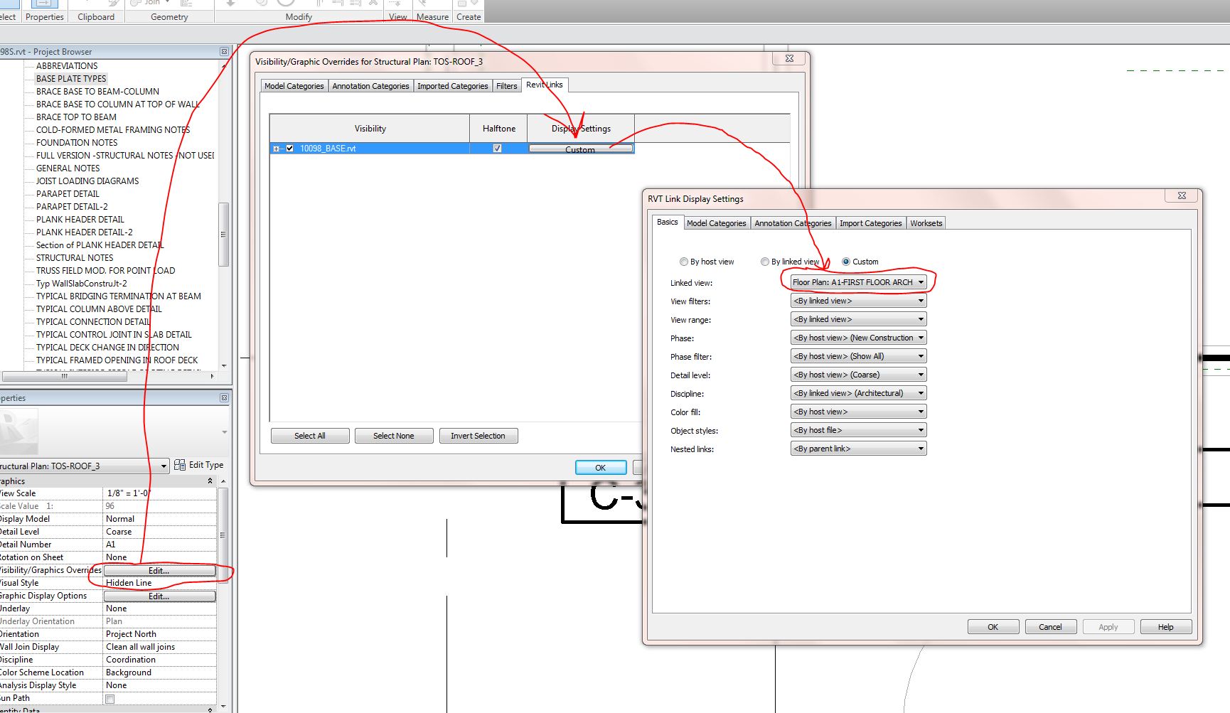

Assuming you are linking an Arch revit file...you're going to want to control the linked file thru visibilty/graphic overrides.  Here is where you control how you want the arch model (background) for your frmg plans to appear.  The major benefit is you are able to select which floor plan from the linked file you want to use.  So if you're on your second floor frmg plan - your linked file can be set to show the first floor plan.
That is just one example - because there are many settings you can choose from depending on how you want the arch background to function, but a linked model should be controlled thru the visibility graphic overrides for each view.
Hope this helps!

I am using a linked in architectural file.  Where do you select which architectural floor plan to view as your base plan?

Visibility/graphic overrides - revit links...see attached pic
