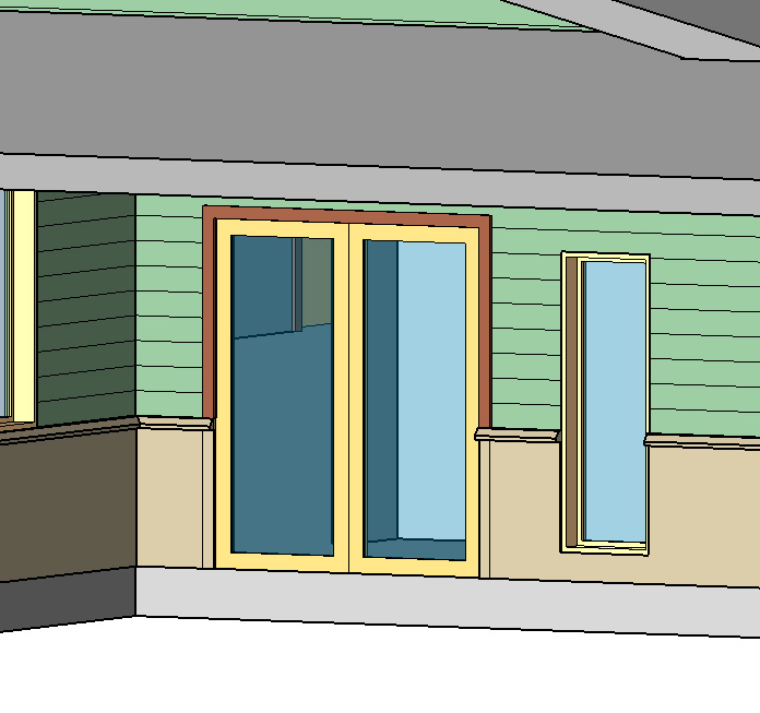

I'm sure there is an easy fix for this, but I can't find it.   Some one help me out.Here is a picture so you can see my problem.

Highlight the sweep and select the blue grip point and move it away from the sweep.

is that the only way to fix that?  This happens everywhere i have doors.  I would have hoped it was easier.

As far as I know that is the only way. Sweeps automatically cut at the opening and any geometry extending past the opening will not be automatically cut. I think that is why there is the ability to modify the end of the sweeps after an opening is cut.

There are no blue grips at the doors only at the ends of the walls.  Sad

Which version are you using. I am on Revit Building 9.1. When I select a wall with sweeps applied (either integrated into the wall family or hosted seperatly) I get the blue grips at the openings as well as the ends of the wall.

In your sweep element properties uncheck the "cut by inserts" type parameter then your blue grips will reappear at evey door insert.

Thank you!  That helped.  The blue grips are back!

Hey, why do my sweeps cut right at the window trim and not the door trim?

That's because of how the opening sketch in your window family lock into the outer frame ref plane. You can also do the same to your door family to lock the sketch at the outer frame of your door so that you don't have to readjust the wall sweep end at every insert. Wall sweep will stop at the end of the opening at every insert.
