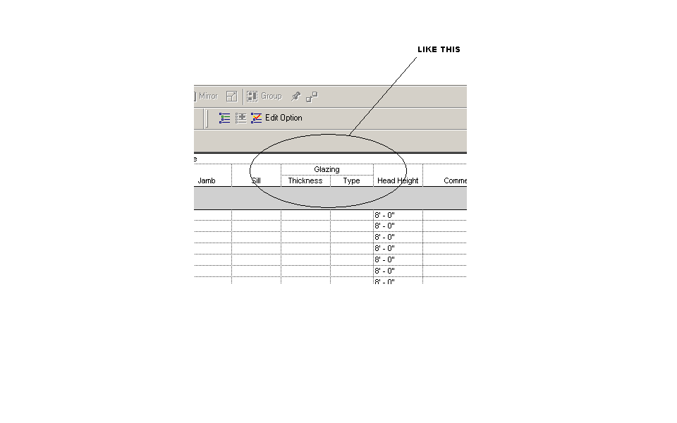

Basically i want to know if i can combine 2 test fields into one so i can have the information that i have put on the 2 fields in the one column i.e
frist field is Type Comments
second field is Comments
and if i can comnine touse fields together so the can be called Overall Comments
is there a formular to do this i know i can do it with numbers
Thu, Jun 7, 2007 at 9:13:27 AM | Schedules combining 2 text fields in to 1
ebtaylor
Joined: Tue, Aug 22, 2006
83 Posts
3 Stars: 2 Votes
do you mean just grouping the 2 text fields and have a heading above them?
similar to the attached?
Thu, Jun 7, 2007 at 10:43:58 AM | Schedules combining 2 text fields in to 1
TomDorner
Joined: Sun, Apr 25, 2004
1207 Posts
4.5 Stars: 25 Votes
Revit does not support text concatenation via formula.  The best you can do is the group heading thing as suggested.
Tom

YES ebtaylor HATS WHAT I MEAN IS THERE A LINK TO ANOTHER FORUM TO SHOW ME HOW TO DO THIS
Fri, Jun 8, 2007 at 7:55:11 AM | Schedules combining 2 text fields in to 1
The fact that we can't combine strings is a problem and I hope they add that feature to REVIT.
What I did when I had a similar problem:
- I placed my columns side by side
- kept one of the column headings (comments) - blanked the other column (type comments)
- turned off the grid so that I didn't have the vertical lines
- added the correct grid lines to my sheet
RESULT - the field has the correct data although there is some extra spaces occasionally between the two comments.
