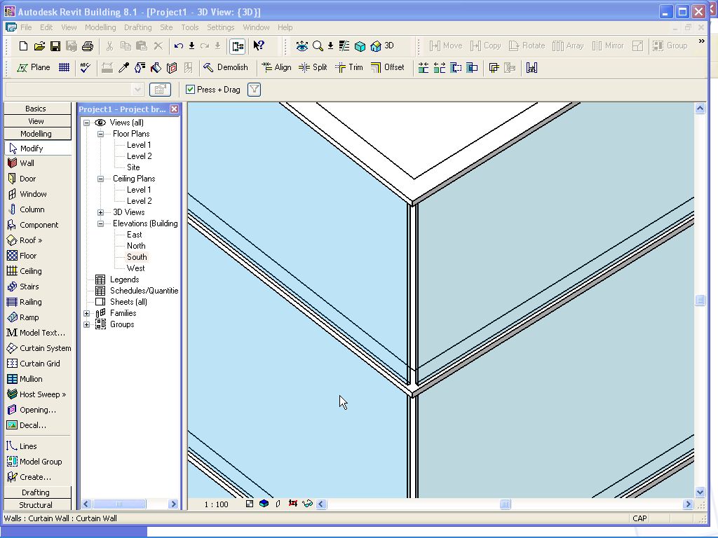

Hi all, please find enclosed image of curtain wall edge joint.
Question: How to make it butt joint without frame at the junction? they seems just dont butt even with curtain wall line joined.
Besides, How many of you find it confusing on the curtain wall flip flop capabilities, with that capabilities, I cant place my curtain wall in the center of the wall line and need to move it in order I can get it to position. Did anybody use the flip option in curtain wall?? I wonder?? I prefer I can place my curtain wall in the wall center. with the flip flop, sometime my curtain wall just don't join correctly at the edge...workaround please from the curtain wall experts...

Curtain panels can be somewhat edited seperatly from the system. You can tab through the selections until you have selected just the panel. There is an edit button that apears on the Options Bar and when you click this button it puts you into edit mode for the Panel. You can then use "Align" to align the edges. You will have to do each panel seperatly so I would suggest making this one of the last things you do to the element.
