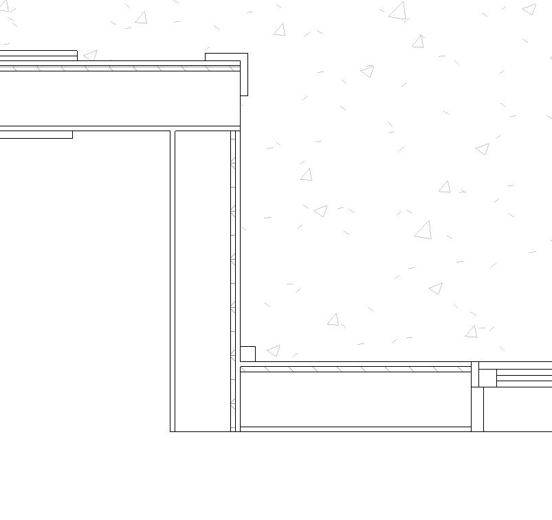

Thu, Aug 31, 2017 at 2:32:51 PM | Corner Trim with Vertical Sweeps
RadiusDesign
Joined: Sat, Jan 16, 2016
0 Posts
i use the wall join configuration tool. make sure your walls are going the right (see attached) make a outside and inside corner profile, vertical sweeps. much easier.
