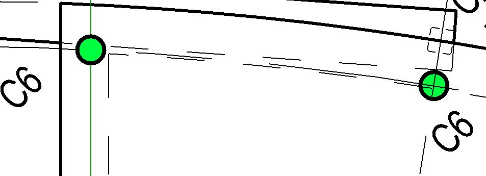

Hi
I have some circular comncrete columns that are set out centrally with gridlines in one direction & an arced detail line in the other.
Their locations are, I'm sure, going to be amended. I would like it if, when I offset the detail centreline the columns move with it. Is this possible? I guess I need to lock it to the interesection of the lines but I don't know how?
Hope you help me
Cheers
Dave F.

I don't think that is possible, detail lines are only view specific. If your line was a grid line you could.
