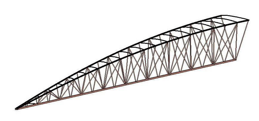

hi I'm working at a project involving a complex steel structure roof.I need to create a mass using a spline profile and also a circular section. I wanted to do that using the solid sweep command but apparently I can't have both a curved path and circular section. The compromise was to use a curved path and for the section to use a  polygon having as many sides as possible . I don-t really like that though....because if I look at the structure closer i can see the edges.
If anyone has any ideea about how cand i do this please help me Smile

I concidered using the void command...but i think it's even more difficult to do that.the most convenient way would be to create a sweep with a curved profile and a circular section.looking forward for suggestions or advices.
the photo I've attached is of a structure (the international airport in osaka ) I've found over the internet but I think it gives a good example for the kind of structure I'm trying to create.

unfortunately I wasn't able to open the file as I am working in an older version of revit. I've attached a photo with what I've come with so far.As I will surely have to make many changes  on the project I'll try to  take your advice. The mass created so far was through sweep with  curved path and polygon/circle profile . Thanx so much for advices Smile
