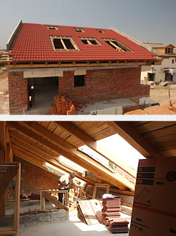

Hello.... i want to use these kind of windows in a roof?! (one manufacturer is velux)
thank you
