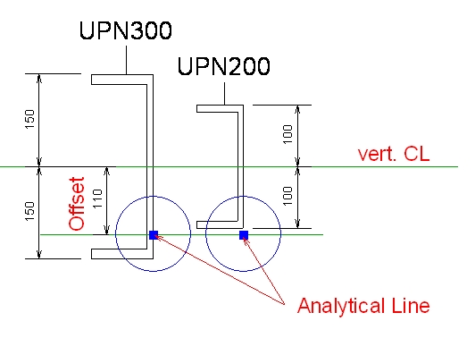

I need to have C-Sections for Columns. Therefore I copied the existing columns-family H-Wide sections and customized  the geometrie. Now I found the analytical line is not in the vertical centreline were I excpected it to be. I don't find a possibility to change the location. Within the family editor I can click the checkmark to show the analytical lines, but nothing appears. Do you have a hint for me, what I can do ? Thanks for your help Jürgen
