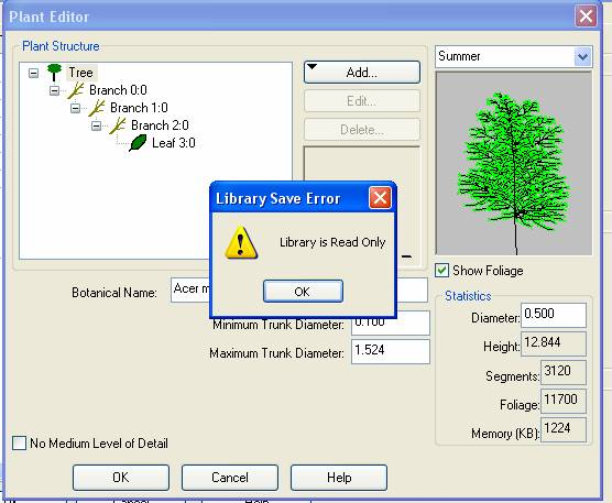

editing trees in Accurender. i just discovered this neat little feature where you can actually edit the rendered version of the tree in revit. well, it was neat until every time i tried to  edit and create a new tree within the accurender… Revit crashes. whenever I try to 'create new from existing' I either get 'library is read only' message below or Revit crashes entirely. anyone have similar problems/solution?

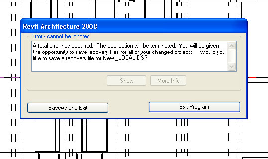

Wed, Aug 29, 2007 at 4:30:59 PM | Crashes with Architecture 2008
#10
gonesouth
Joined: Wed, Aug 8, 2007
2 Posts
I've recently started using REVIT Architecture 2008 and have been getting this error message all day. It seems to happen when I try to insert a window family which I created (the window family is fairly simple).  See image attached for error message.  Any suggestions would be more then welcome.

Gone South that oculd be caused by a number of issues. Try doing an audot on the file if that doens't work then you really have 2 options. 1 send it off to Autodesk support or 2 go back to some of the backups and see which one opens fine. Then do an audit on the file.
 If you don't know how to do an audit just go File Open>and click on the Audit command near the bottom right.
Robert you really need to try and bring your files down in size. Are you using a lot of Autocad files or in place families? Do you purge regularly? I know that you do a file Save As quite often so it can't really can't be that.
Fri, Oct 19, 2007 at 10:44:01 AM | Crashes with Architecture 2008
#12
gonesouth
2 Posts
Elmo,
 Thanks for the tips. I tried all those along the way. Sure enough I found out that Revit had a bad sector. I had to uninstall and then reinstall Revit altogether. It fixed all my errors.
thanks again.
