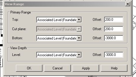

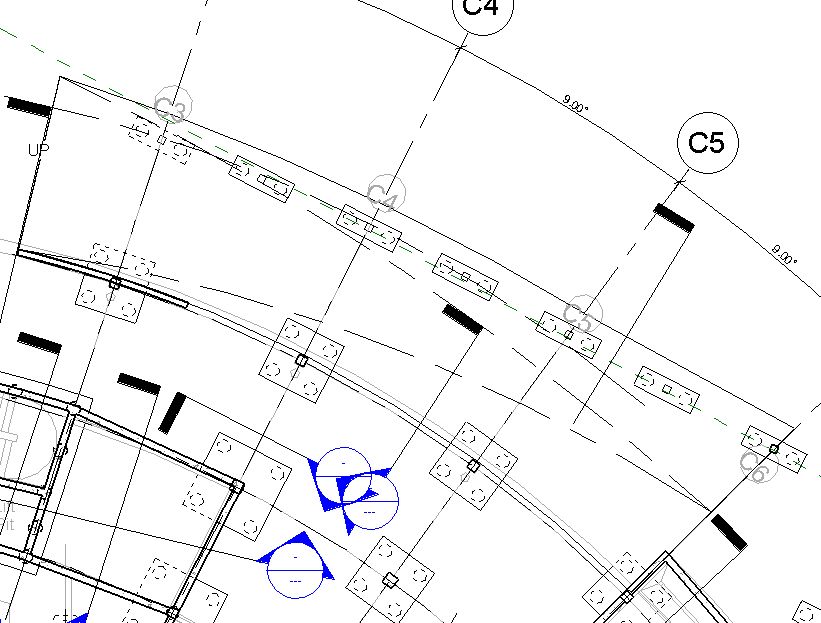

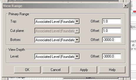

I'm not sure if I'm doing this correctly. I have a plan (Foundation) that has a ramp 350 insitu concrete. It goes from Foundation level up to Ground. From the attached view range image should the ramp be visible? It doesn't appear to cut.
Any ideas for a solution?    Thanks, Dave F.

Woops, uploaded wrong image

Rather use a sloped floor to make a ramp, then it should cut if your view depth is set correctly!

Tried that! but because it's curved! & as I'm sure you know,  slabs can only fall in one direction! This causes the top edge of the ramp to fall! Which is not what is required. Can ramp not be cut or am I missing something?

A plan region will be the best solution around the ramp, use it to minimize the amount cutting, than you might use a solid white region hatch and some drafting lines...Check in your help files to explain plan region if you have not used it before. Sorry did not look at your attchment to see it curves!
