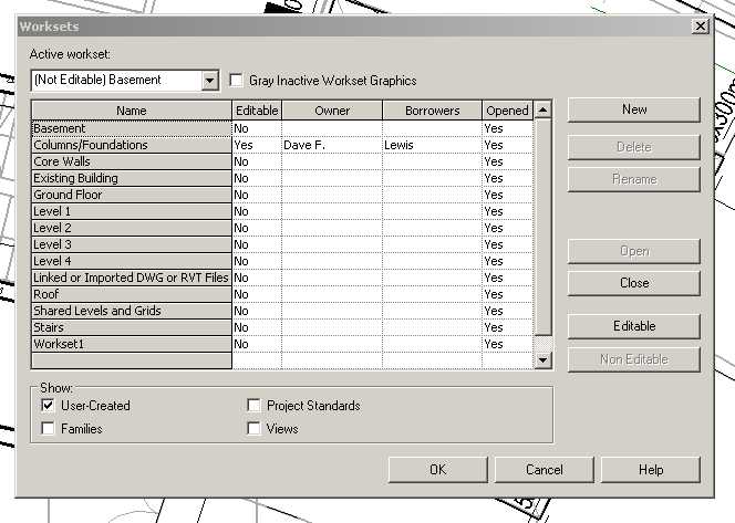

Hi
I'm using Build: 20061022_1700
About an hour after I set the workset to editable it dispalyed that my colleague was a borrower.
I'm 99% sure it wasn't when I logged on.
Anyway, the problem is can I turn this borrow off? I don't know his log-on.
Is there a way to overide it?
Thanks in advance
 Dave F.
Tue, Apr 24, 2007 at 8:08:01 AM | Workset being borrowed by someone who's not even in the office?!?
twewer
Joined: Tue, Nov 1, 2005
10 Posts
Change your user name in Revit to his and relinquish the workset.
Tue, Apr 24, 2007 at 8:19:28 AM | Workset being borrowed by someone who's not even in the office?!?
DaveF
Joined: Sun, Mar 26, 2006
83 Posts
How would I do that?
There's nothing in the manual under username.
I thought the it was taken from the users computer login name.
Which on a network, two can't be identical. Is that right?
Tue, Apr 24, 2007 at 8:26:16 AM | Workset being borrowed by someone who's not even in the office?!?
twewer
10 Posts
Under Settings- Options on the first screen you will see your user name.  Just change it to his name.
Tue, Apr 24, 2007 at 9:25:52 AM | Workset being borrowed by someone who's not even in the office?!?
DaveF
83 Posts
Thanks
Rollback
