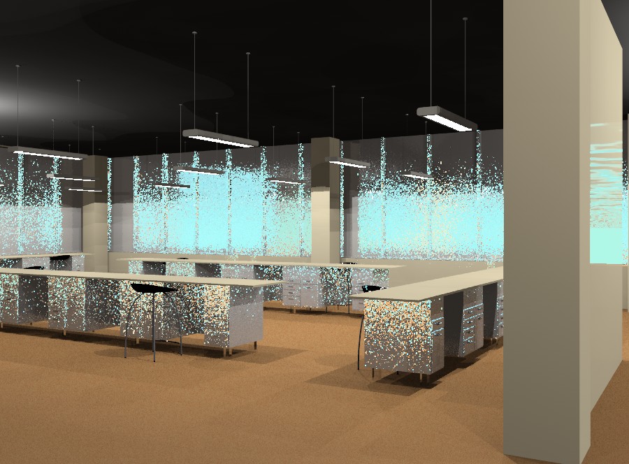

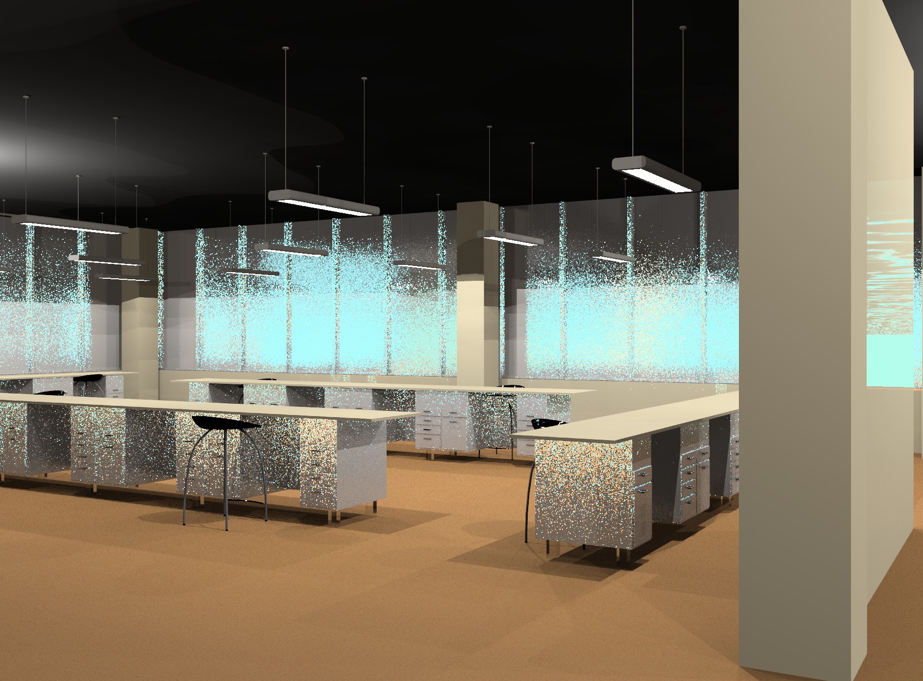

Hi everyone
 i am having problems with rendering. I am fairly new with the program and I rendering for the 1st time. I have done my radiosity before rendering and i started on presentation and it looked awful! and then i did a medium dpi rendering and it doesn't look great either. Some of the furniture is all splotchy and the windows are splotchy and you can't see outside! i need help this project is due in less than 2 weeks! Thanks!
Mon, Apr 23, 2007 at 6:18:13 PM | help with rendering!
Mr Spot
Mr Spot Avatar
Joined: Mon, Jan 12, 2004
2889 Posts
4.5 Stars: 93 Votes
For starters you need to have a look at the materials you are using for glass and the cupboards.  They have far too much bump mapping and reflectivity...  You may also want to add a couple of studio lights to enhance the ceiling lighting a bit more.  Reflected light in accurender lite is rather poor so it needs to be enhanced manually with extra lights.
