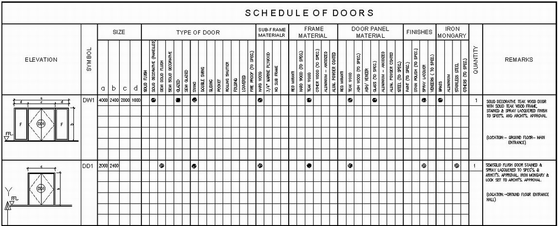

Thanks for the prompt response to my queries.  I shall check the underside of the staircase like you told me to.  Meanwhile I have attached the jpg screenshot of what my schedule in autocad looks like.

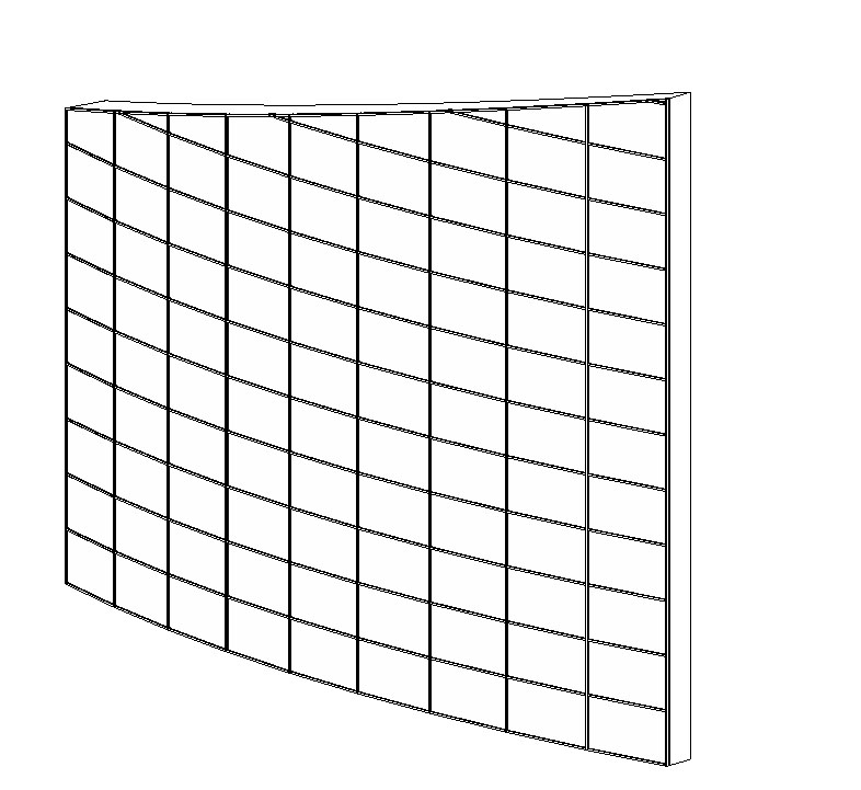

5 Stars: 1 Votes
Dear Coreed,
Thanks for the method . It worked.  The only issue with this is the curved part cannot be made as a wall, it has to be a curtain wall system. Hence if there is a way to convert that particular curved mass into cuved wall (masonary wall - non load bearing) You can see the attached jpg for what was allowable when I made the mass.
Thanks again..I appreciate it. awaiting your suggestions for the mass.

Quoting Jays08 from 2007-04-22 03:54:43
it shouldn't matter if the mass face is straight or cureved, you should be able to apply a "wall by face"

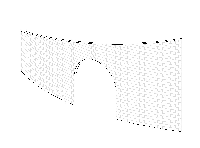

This took all of about 5 minutes to create using the steps our outlined above (in the tutorial).
Regarding the Schedule i can't see any reason why you couldn't have your schedule display that way in revit.  The check marks you have for materials would mean you'd end up with a lot of parameters in your door families...  It would be a lot easier to simply report the revit material that you've used in your family.
To have it display the way you are after the example column will just be a blank column that leaves space for you to insert your legend components in.  Use the remarks column to make the example column big enough.  You won't be able to get the excess horizontal gridlines you have for each door type.  You can however group your headers like you have.
