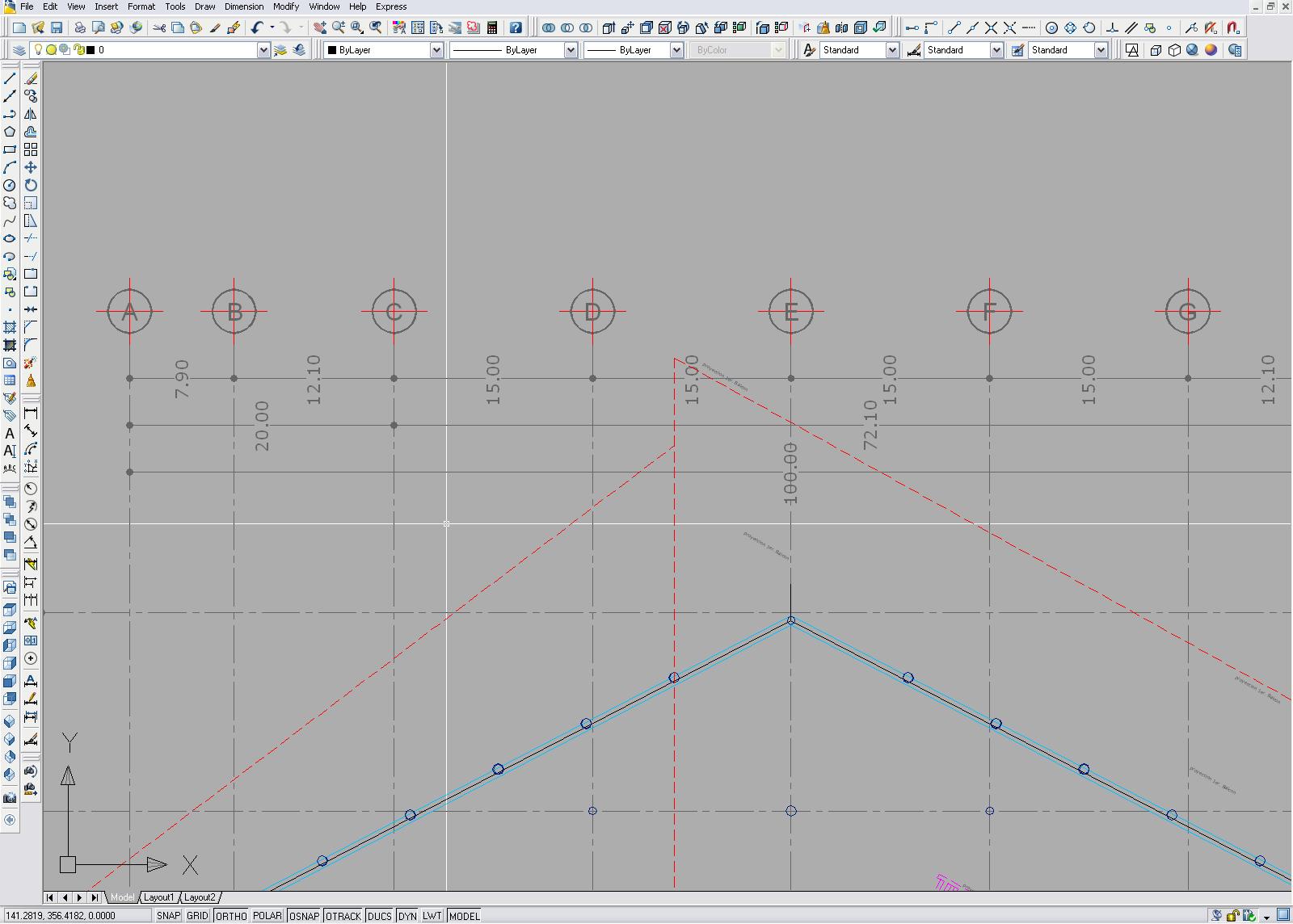

Hi to everyone.  im trying to customize the bubble`s grid, there are some ways to get that? or any family can be downloaded is avaliable?

i don't understand, the image is Autocad

ok. i want to change the bubble style, how can do that? i want to cutomize it , like autocad's image .

Create a new grid head family or simply edit the existing one and rename it.
Then select one of your grids in revit, select its properties-->Edit/New-->Then select your new grid head in the symbol parameter.
