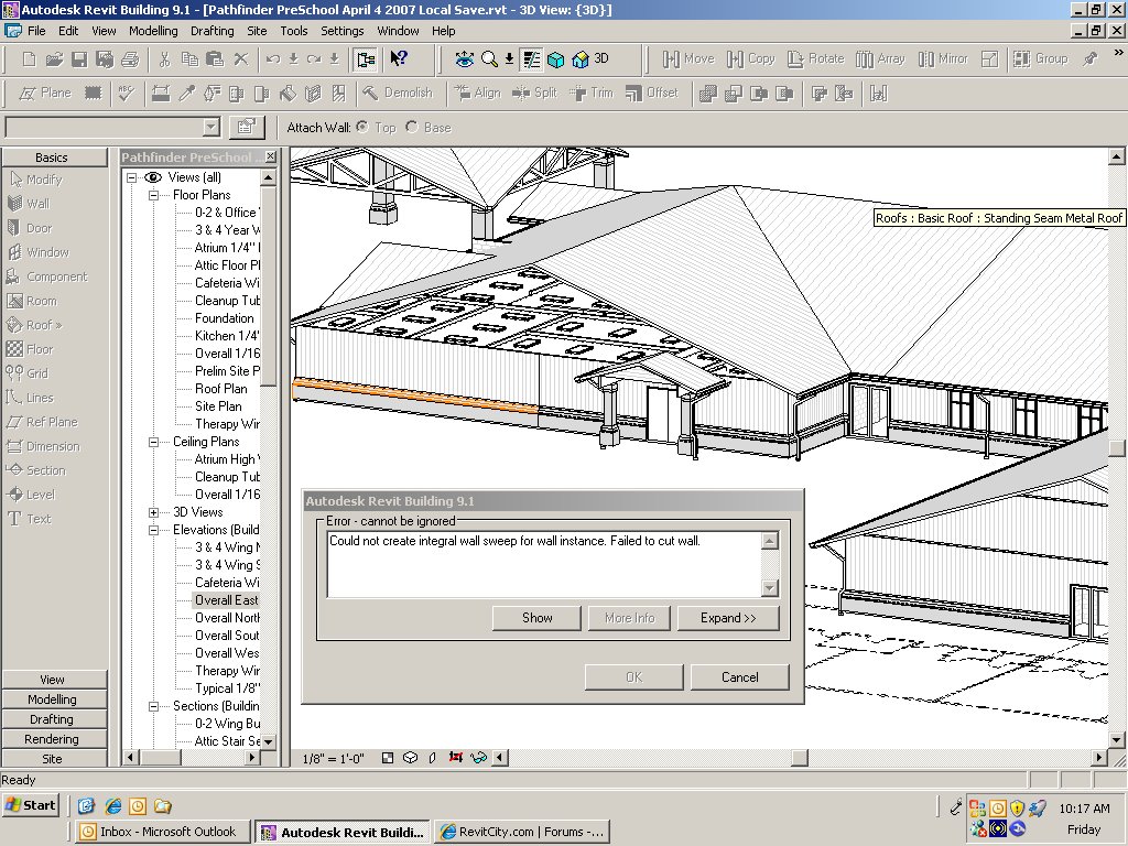

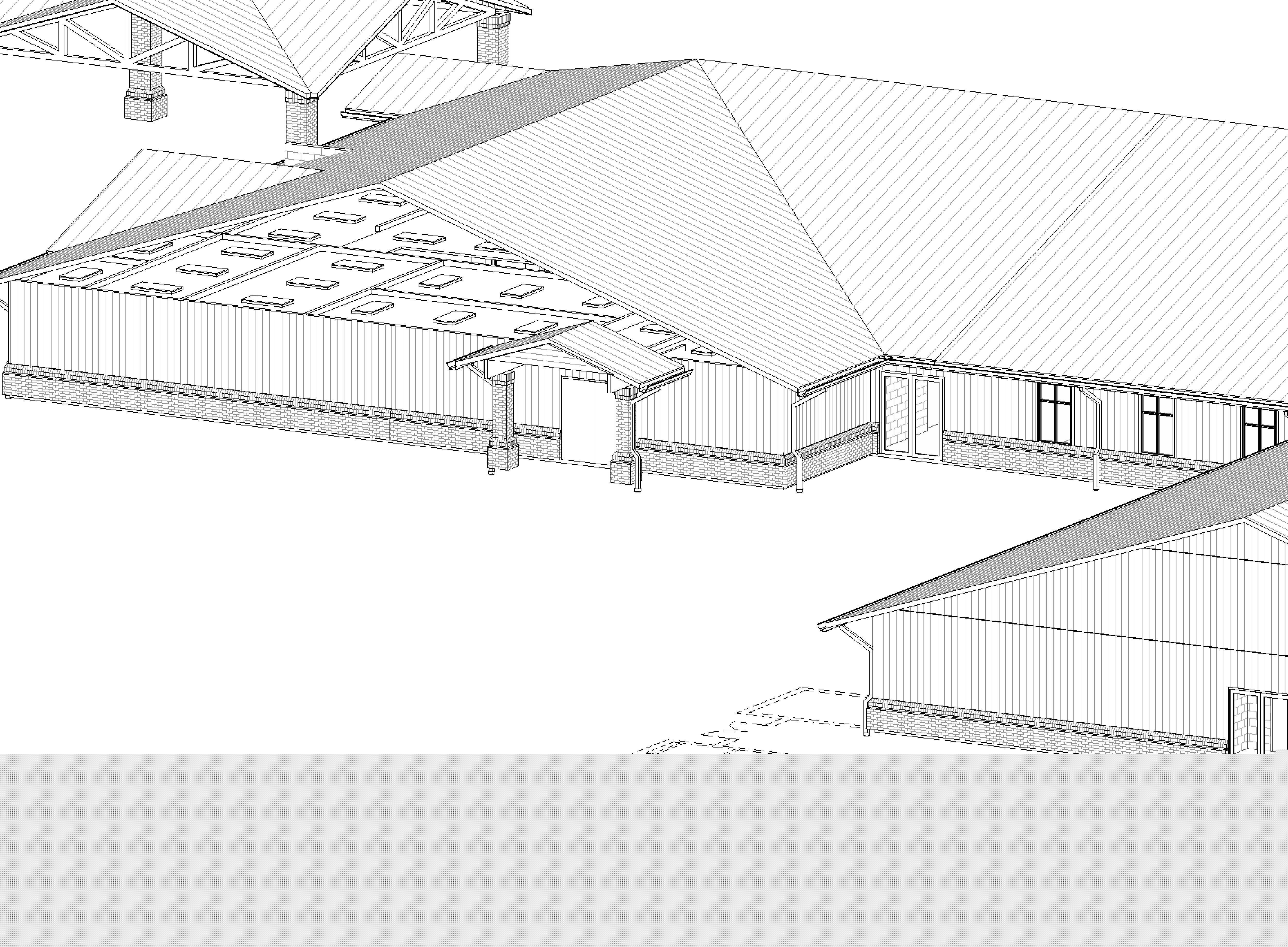

The two gables in the attached image are identical instances of the same wall.  At one time, both gable stack walls were attached to the same roof.  Now, only the one on the right still is.  The one on the left "went nuts" and suddenly all three walls in the stack wall became attached to the roof.  The only way to fix it was to detach the walls.  Now, I get the error message about sweep unable to be created and nothing happens when I try to attach, nothing happens when I try to edit the profile, I seem to be unable to recreate the gable wall that was there for a long time until it went nuts.  Meanwhile, the same wall is just fine for now next door attached to the same roof.  Why can't Revit get stack walls to behave!!!!!!
Fri, Apr 6, 2007 at 10:21:17 AM | Try again with inserting the image!

Fri, Apr 6, 2007 at 10:25:04 AM | Here is the error message!
Hogmodo
Hogmodo Avatar
Joined: Tue, Jan 6, 2004
367 Posts
3.5 Stars: 6 Votes
Received when I try to re-attach the previously attached stack wall!
